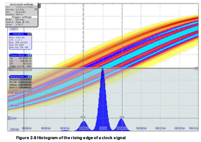

Let's first look at an "analysis" of jitter distribution (as how it is called) of a digital scope (courtesy Rohde & Schwarz) :
Watch the more horizontal beam which is the "analysed" representation of the signal of an oscillator and how the more light blue colour denotes more intensified jitter. Read this as : The light blue colour denotes the most occurrence of the signal. This is how the mid of that beam is the most intensified because it is the signal itself and the deviations (jitter) of that signal are less in occurrence so less intensified.
If you look at the plot in dark blue at the bottom of the screen you see how the deviation of the signal can be plotted and you see two major side beams. The right hand one is the highest and you can see this as the secundary light blue beam in the horizontal main beam. The left hand beam in the plot at the bottom is lower in intensity and this represents the dark blue beam in the horizontal beam.
Lastly, you can see a second side beam in the left hand side and this is the more orange colour in the horizontal beam.
Hard to read is the 51.2ns of deviation to the perceived optimal signal which shows on top of the right hand side beam at the bottom. This means that there's a frequently occurring jitter of 51.2ns towards one side of the optimal signal; when the left hand side beam would also show 51.2ns (but this is not readable) it would mean that peak to peak jitter is 102.4ns for this more intensified (more occurring) deviation. Mind you, only for these more intensified parts because you can see there is jitter beyond that - and it extends to the yellow (least intensified) beams in the horizontal beam. With some visual interpretation you can see that this spans around 400ns just because the distance is around twice that to the light blue and dark blue beams shown in the horizontal beam.
Got that ?

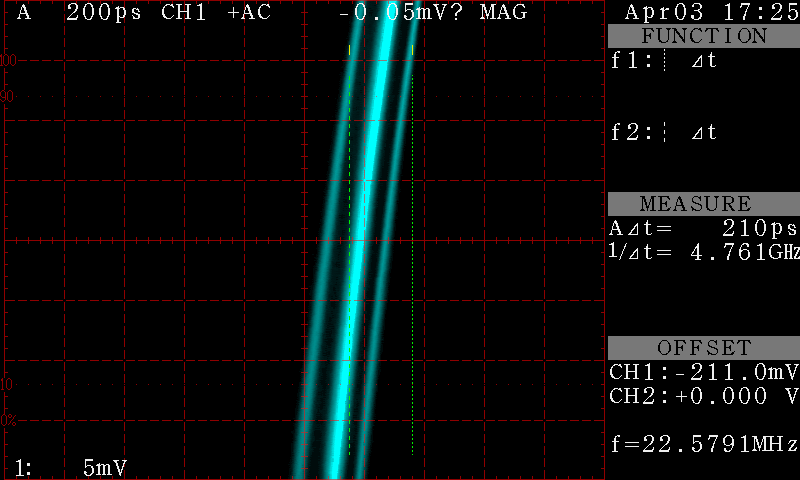

Then let's now look at the analogue scope and what we can make of that :
This shows an 1KHz signal and you actually see exactly the same. One difference of course - it is one colour only and the more occurring deviation (jitter) shows by the more intensified beams;
You can see that the optimal signal - now simply and "honestly" derived from the most occurring signal without any math - is in the middle and that at equal spacing more occurring jitter shows; as in the (first) example picture you can see that the distribution to the left and to the right of the signal is not equal; to the right there's more intensified and less spread deviation and to the left it is more spread (wide) and shows (thus) more vague. With some experience you could see that the deviation to the right and to the left in itself is equal but the deviation to the left is more "wobbling" in itself.
Notice that "to the right" means "late" and "to the left" means "early". So we have jitter that makes our samples come out later than intended and also more early than intended. And, the distribution of that is not equal.
Mind this word "distribution" because in the end a lot is about that (for Sound Quality).
If you look to the last picture and now concentrate on the middle of the beam (the intended signal) then you can see there too a more intensified and less intensified part. So, don't think this is just the "phosphor" of the screen dying out or something - it is just jitter again and, there too, more deviated to the left than to the right and again the early samples are more "distributed" than the late ones.
Lastly for this picture, notice that the parts between the middle beam and the outside ones are completely black ...

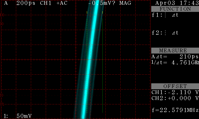

While the previous picture shows a 1KHz test signal, the last one shows normal music playing.
Aha.
What insiders right away will tell us, is that this is thus "data dependent" jitter. Well, don't believe everything they say (and decide whether you believe me or not) but as we already know there is more going on than data impeded jitter as it formally exists (without explaining what that exactly is at this time) - and this is i2s dependent jitter. This too I won't explain plus it has been sorted out by "us ourselves" (with  Nick in the base).
Is it really i2s impeded jitter ? maybe maybe not, but it is dependent on things beyond known (formally). Look :

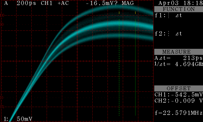

This time again music is playing, but now it has been attenuated by 144dBFS. In't that interesting ...
If you compare this picture with the previous one you will be able to see how "volume" plainly creates jitter. All you need to do for that is seeing that the main beam almost has vanished at that almost all has been spread into deviation.
But not so with the last picture !
Side note : Can you already see how "jitter analysis" (from reviews or whatever other means) need context never provided (because not recognized) ? This is how I love this ... Something new again. Something new to work with.
Here you see the same but now attenuated to -120dBFS.
See ? it already starts to happen.

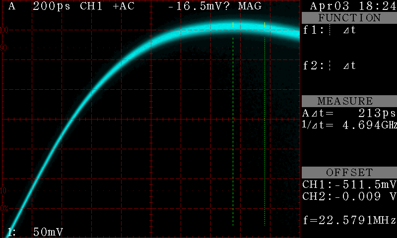

On to something new again (for the world and as far as I can tell) :
What you see here is the top of the oscillator's wave cycle (but with amount of 1 giga scans per second again) and you can clearly recognize that what's shown there has to resemble 100% what was shown before. The difference ? this is the "level" of the output voltage and not the time domain as such. Now, with the notice that the horizontal scale is 50mv per division, the "peak to peak" level variation shows something like 100mV (on a total of 3.3V peak-peak);
It is not said that the same happens to our audio samples (I did not check that) but it can be expected. Thus, this is again the oscillator output and "something" influences not only the time stability but also the level stability (output voltage stability). And since the "jitter" distribution looks the same, its source will be the same (whatever that source is).

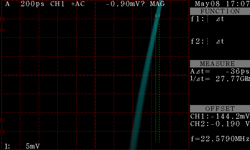

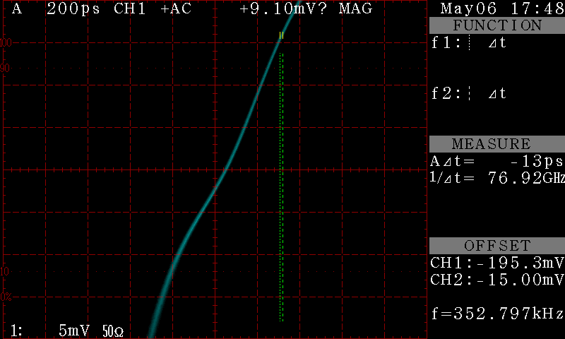

But let's try to improve on this; what we can measure can be improved;
Aha. Well, between what you saw from the previous pictures and this one reads like a 1 minute change but take it that it really was two years. Even more actually because some know I have been working on it forever.
Anyway now it shows 13ps;
Watch out : This 13ps is measured peak to peak while general "one number" jitter figures are expressed in RMS and this also depends on the distribution; we can't do the real math from looking at a beam like this but think that for the RMS figure very roughly the 13 can be divided by 8 (so RMS jitter would be something like 1.625ps). Remember, "very roughly" and it can be higher or lower.
But is it 13ps or is it actually "analyzer limit" ? It is the latter. How ? well, it is just the beam of the signal and although I am able to minimize the beam more than you see, it comes down to showing "no beam" if less width of it is to be shown (those familiar with scopes will readily understand).
So I can only show the width of the beam and as long as no more intensified parts show (which it does not), it shows "no jitter".
Of course there is jitter (because no oscillator exists without jitter) but at least it will be under 13ps. And, if all was done 100% right it will be the 200fs rating of the oscillator.

So what happened to the last situation shown ?
I hopped up and down on the floor;
While jitter will be under 13ps inherently, I implied a 36ps of jitter which was incurred for by vibration; you can't see it here, but the one time the beam would jump to the right, the other to the left and after a few minutes of exercise on the floor this came out of it.
So be careful of what sound pressure (or speaker vibration) itself can do - not much different from the vast importance for turntables regarding this.

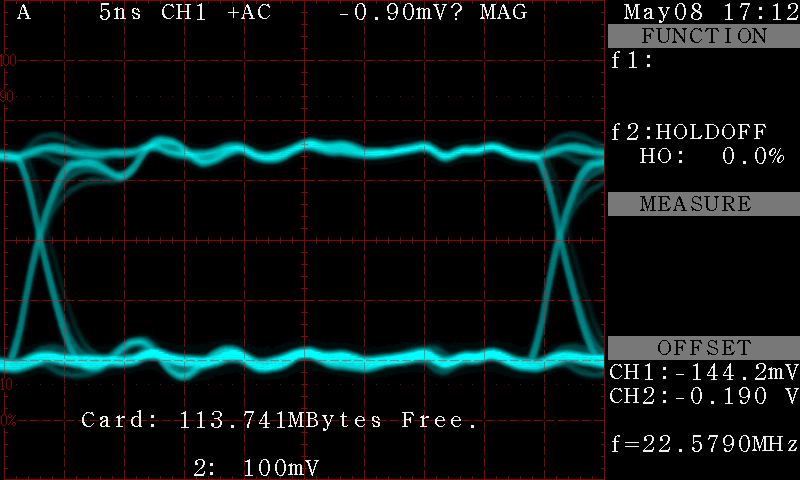

As a bonus, here's the eye diagram at a sampling rate of 352800 and with the (phosphor) intensity full open for 15 minutes. It looks the very best (Google for pictures of eye diagrams).
Notice : In itself the eye diagram only tells about the headroom available for errors in the D/A conversion. So this can be seen as when there's so much jitter that there's no opening (this is the part between the crossing lines), there are no continuous "signal edges" to let trigger the output clocking upon (always).

Hey Peter, your traces look very similar to those that Keith Johnson showed in his talk at RMAF2010. I've watched the video of the talk a few times now, and I've found it very helpful. (But you have to persevere.)
Mani
