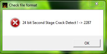

« Reply #3 on: December 11, 2009, 10:59:18 am »
This is a very high crack,
You know what, I turn it off, happens too often now a days.
Roy

« Reply #4 on: December 11, 2009, 08:39:25 pm »
That amount is still normal (but already in the range you won't know in advance).
0.9y-5 will be better on this !
