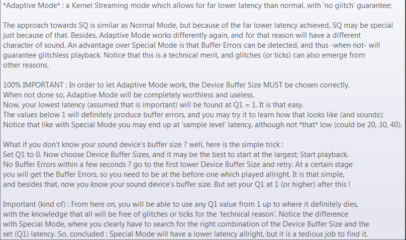

  • A new Kernel Streaming "Adaptive Mode" has been developed with again another nature of sound. Its main reason of existence though is its similarity to Special Mode for ultra low latency (not *that* low, but towards 20-100 samples anyway), but in the "normal" way of working. This means that the X3PB log file will report on Buffer Errors if they are there, and thus will guarantee you to be without them (if they don't show up).
    Note : Before the Buffer Errors for Normal Mode were shown per 10, which now has been turned into per 1, and a withgoing time for your conveniency ("when did it actually happen ?").
    There is still some calibrating to do, but this can be done a. way more faster than Special Mode and b. now can also be done for sound devices with unknown buffer size.
    Please see below first picture, which is a screen copy of the Tooltip concerned (on the new combobox "KS Mode").
    Important : (kind of) : if you want to go back to the "feel" of the first Kernel Streaming versions (0.9y-5-00/01) which worked for some, select the highest possible latency of the sound device (first find out your sound device's latency if you don't know it, see tooltip !), and next set Q1 to 30.
    You hear the (huuuge) difference, right ?

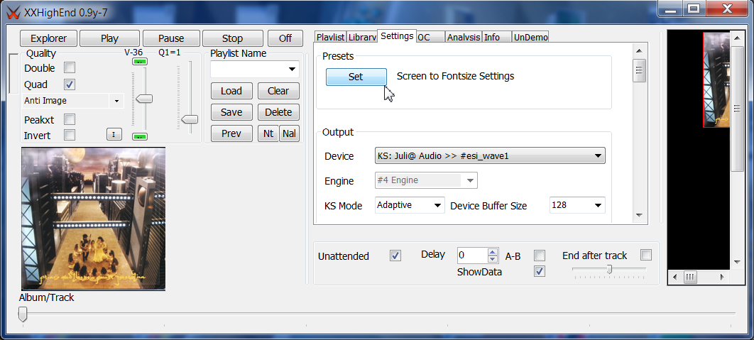

  • As per an OS setting, the Font Size can be set to 125% or 150% of the normal size (btw, 125% being called "normal" by the OS) (see Configuration Panel, Monitor). So far, XXHighEnd never incorporated this feature (unintendedly), therewith making a mess of the screen at settings other than 100%. Now, all has been made adaptive to that. See below second picture for an example of it. Notice this shows at the real 125% size.
    At switching from one Font Size to the other (which requires a reboot), the first startup of XXHighEnd will show a wrongly organized screen. In order to reset that to normal workable proportions, the "Set" button in the Presets section of the Settings Area is available (again, see second picture below).
    (the Presets section will contain real presets in a future version).
