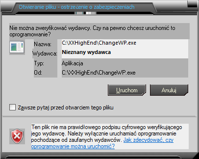

I tired to install 0,9z on Windows7 Ultimate 64-bit polish edition.
First I noticed, the color scheme of first and every next screen looks strange. I attach a copy. Text area is different color than background. I have 1280x800, 32bit color, tried to change to 16bit but this does not help - the screens look the same. This is nothing however.
Program says, that several programs will be started, you know what I mean. So first goes the screen in attachement. You have to imagine this screen in english or dutch - looks similiar.
I I click Run, than the same screen appears and I can click Run forever... If I click Cancel, the next dialog about the next program appears.
Is a problem with 32-bit subsystem of 64-bit systems ? Still, cannot make it running. Of course previous version works fine.
Hi Jarek, I had this problem too. I had to click cancel for many of the various programs. For the most part XX will work though not all of it will. I believe Peter will have this solved soon. Not sure what you mean by the color scheme problem. The new GUI is completely new including the colors.

The 0,9z version is not working in my case as you say. When I click Cancel to all the dialogs that appear on sturtup about programs that need to be run, I have to set all the options in program. When I exit the program to have the settings stored, I have two screens with error (one about running a program exactly the same as in the first post and one about 32-bit susbsystem issue).
After that when I try to run XXHighEnd again, it shows up after about 1,5 minute (for the first time after a second or so), and than displays message to load or not previous settings. No matter what I choose, settings are lost. And again, several programs need to be started, and things remain the same.
Jarek

Jarek - Sorry for your inconveniences, but all is known, although it may not be all that logical to predict the effects of things. So, the main issue is the programs not being able to run (only Cancel frees you from those screens), but in the mean time it implies you can't run those programs. It just can't work. Not on a -to XX- new machine. You'd have to give this up for now.
But wait ... you may be my test case (please) ...
Paste the XXHighEnd.exe from below zip over the 0.9z install.
Don't forget to answer Yes to each of the questions now. I hope this now works, and can't test it myself (unless I find in the Registry to tweak these things back to "never ran before").
Let me know if this works.
PS: The colors from those screens are expected. I must see whether I can do something about them. Notice though that normally this isn't badly looking at all, as long as the texts are properly alined. And, I see now that in your polish version this is not the case.

new version is working fine, all issues reported by me in this post are not existing and are solved.
Can I use it, or there is any temporary trick here ?
Jarek
