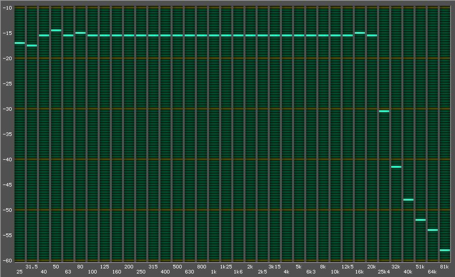

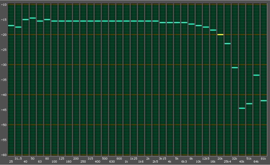

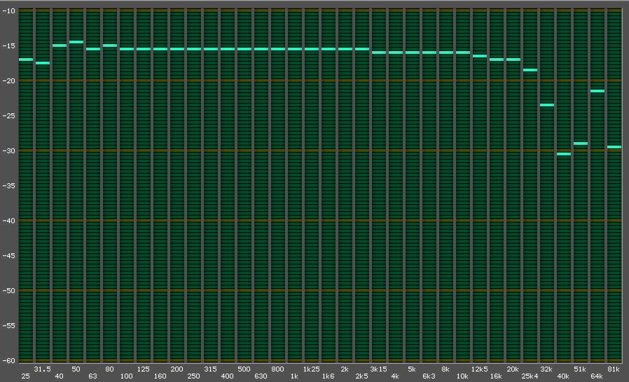

I did this a while back, but with some new filters in XX, I thought it'd be interesting to repeat it.
I have a 16/44.1 wav file that sweeps from 20Hz to 20KHz in 33 seconds at a constant level. So, I simply play this file in XX and monitor the output of XX using RME's 'Digicheck' software.
A few notes:
1. I don't think it's wise to equate any of these graphs with SQ.
2. I'm not sure what happens below 100Hz with 4x upconversion applied - a bug in the RME software maybe?
3. My ADC/DAC is capable of 4x upconversion internally - the output looks identical to 4AI in XX (I had to use a separate laptop/card to generate a 16/44.1 input for my ADC/DAC and then monitored the 24/176.4 output from the ADC/DAC on my main PC - but I forgot to capture this image).
Peter, are these graphs as you would expect? I was surprised by the 4AP graph...

« Reply #1 on: August 02, 2010, 11:25:27 pm »
My guess: The "AP" process is triggered by square waves, which aren't present in your test signal.  unsure
« Reply #2 on: August 03, 2010, 10:43:24 am »
Agreed.
So, I was expecting 4AP to look similar to 4AI (for these sine-wave sweeps at least). Actually, it is pretty similar above 20KHz... but there is a slight HF roll-off beforehand. I guess this due to artifacts above 88.2KHz, which I can't measure.
In which case, I don't understand is why 4AP is more rolled off than 4_no_filter at ~20KHz...
« Reply #3 on: August 03, 2010, 11:28:23 am »
Well, that costed me a sleepless night ! nea Ok, a bit then.
I think it is good to look at the "no_filter" first; Here we see what happens when nothing is done. The roll off starts at 3KHz and at 20KHz it is -1.5dB. At 16KHz (say, audible) it also is -1.5dB.
The drop in output volume is caused by not all samples are registered on the peaks of the original wave, so the average output of such a periodic wave gets lower (plus it's no good sine).
The energy beyond 22050Hz are images, and -roughly said- are caused by the wrong shapes of the waveform.
If we now look at the 4AI example, we see that this filter is constructed so that there is no roll off in the audible area at all, at the cost of ringing (which you can't see). Notice that the 0.5dB rise you see at 16KHz is real, because no filter of this kind can be "linear". Notice that these bumps (can be pits as well) depend on the frequency, and 16.00KHz can be totally different from 16.01KHz.
The 4L example (Linear Interpolation) doesn't help a bit, and only the images are lower in volume. The roll off is even higher than with no_filter.
Finally, the 4AP example shows that the roll off has been "postponed" to 10KHz, at 20KHz it is at -3.5dB and at 16KHz (assumed audible) it is at -1.5dB (compare with the -1.5dB at no_filter). Btw, you could try to run this through 2AP, in order to get an idea (extrapolate the data) of what will happen to 8AP which is what it should be at least according to me.
What you also see (as far as the details allow this to see) is that there is no imaging beyond the audioband, and what you again can not see is that there is no ringing.
Having said this all, no, maybe I didn't expect the roll off to start that soon, especially because I never saw it in my own FFTs. However, alhtough the 1.5dB (or 3dB) isn't all that much, how can it be more than no_filter. We must be careful though how the "FFT" of Digicheck works, and whether it's "good enough", so to say;
If we look at the low side, we always see the exact same problem there, while I know for sure this problem doesn't exist with AP. I know this, because it *is* an attention point with normal filtering (think about the slowness of low frequency waves and how many samples it would take to "reconstruct" them), while it per se *can not* be a problem with any means of pure interpolation (like AP and even Linear Interpolation). So, while it must be Digicheck doing something wrong here on one side, the behaviour looks very much to normal filtering on the other. Also notice that measuring devices always offer the option to highpass (like above 20Hz) and lowpass (like under 22KHz), and to me this looks like highpass above 100Hz or something, and THUS exhibiting normal filter behaviour there.
All summarized for now : don't forget 8AP is minimum to let this work properly, and that this is also audible.
Maybe I can try to show the same (via DigiCheck) with 8AP. If time permits.
But there's also the FACT that peaks-points in AP are not touched (as they are not in Linear Interpolation), so they sheer can not be lower than "doing nothing". It must be my conclusion that the FFT of DigiCheck isn't incorporating (or interpreting) the phenomenon "VRMS" very well, because it is that that only can be *higher* compared to doing nothing.
Lastly and additionally, remember that this is about periodic waves (never mind it is a sweep, because per frequency it will be periodic long enough to count as that), and while AI will benefit from that, AP is totally unrelated. And, since music isn't about periodic waves you may wonder how AI would (be able to) perform, while AP just shows reality as if it were music. That "squares" (better : transients) are (almost) fully pertained with AP, while they vanish into sines with AI is also a fact, but hard (impossible ?) to measure.
