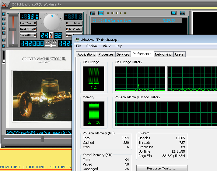

I have 3GB in my system, and 1GB of it is RAMDisk. Whether it be a native 24/192 (see below) or upsampled to that, it doesn't matter (uses the same amount of memory). My SFS is 240 here ... (mind you 0.9z-3 ... with 0.9z-2 and earlier that would be impossible).
Even the 192 upsampled to 384 still plays with 240.
It must be something about contiguous memory not being available.
