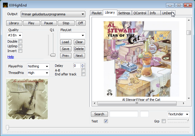

Currently, many of the kind of Search Criteria depend for workability on the size of the images (coverart) you selected. Start small. The larger the image sizes, the longer it takes to present the results. With the default right after getting this version, however, all works okay for the largest size.

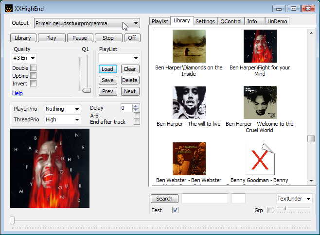

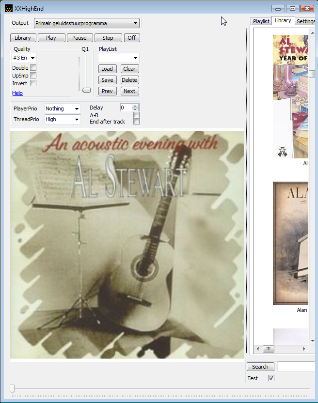

As you can see below, coverart may now be shown as large as it can fit on your screen, which is done by means of
a. the height of the form
b. the width of the left-bottom area.
The latter is done by means of a draggable "splitbar" which is at the position of the mouse pointer as shown in the bottom picture below. You catch the splitbar when the mouse pointer changes into two small bars with arrows to the left and right (which could not be caught by the image copy program which was used here).
Since the images need to remain square, its the combination of both height of the form and position of the split bar which determines the size of the image.
During playing with - and exploring things, do not uncheck the Test Checkbox as you can see in the pictures below. It will prevent from outputting more than 100 items in the result list as shown in the Library Area. That's always much less than the 50,000 you might have with choosing a too large image size nothing can cope with.
Get yourself familair with when - and when not things change in the Library Area. Example : changing the Picture Size (as per the slider in the right bottom) only has effect after pressing Search again; there's more of these things.

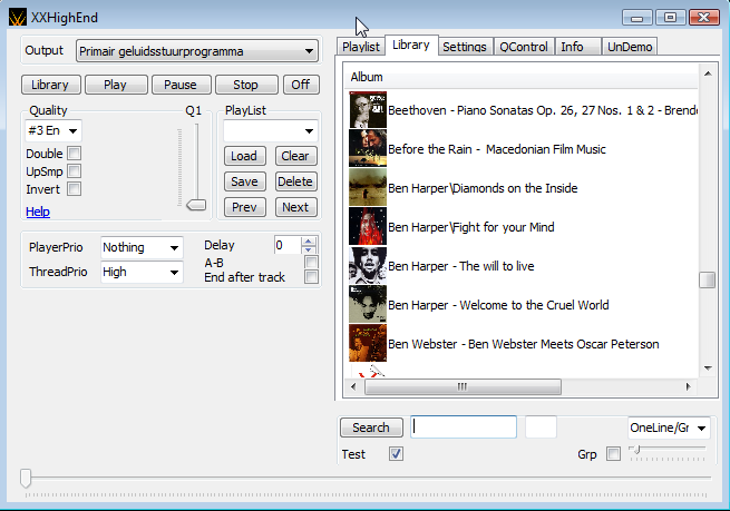

Do not forget that within the Library Area you can actively search (by just typing) in the items (from left to right), which usually is an Album Name, but which can be different once you check the Grp checkbox. When you do that indeed, do not forget to select the "View Setting" as per the combox at the right and set that to OneLine/Group.

Important : The zip at the bottom now contains an additional nopicture.png. This is for showing explicitly there was no coverart found for the Album concerned (see last screen copy below the second picture at the right with the red cross, with the text "Akoest" just visible). So do not forget to include this file in your current XXHighEnd folder, or otherwise search results will be incomplete (searching stops at locating this file while it's not there).
Even more important : Currently some raw intelligence is applied in separating Artist Names from Album Names, while all includes your structure applied (also see Most convenient Storage Structure ?). Please note that your deviations from the applied intelligence here will be the cause of Search Results not showing the proper data, when the Grp checkbox is checked and the View Settings have been set to "OneLine/Group". Better solutions for this will grow in time. Do not hesitate though to show your setup when things are not working out.
See, as an example, the one but last screen copy below and the Ben Harper albums; the first two are stored in a Ben Harper folder, while the next two are stored at the one-higher level, the Ben Harper determined by the part before the " - " as you can see it in the folder name (that's what it is). If you have that differently, things currently won't work. But please tell what you have then.
