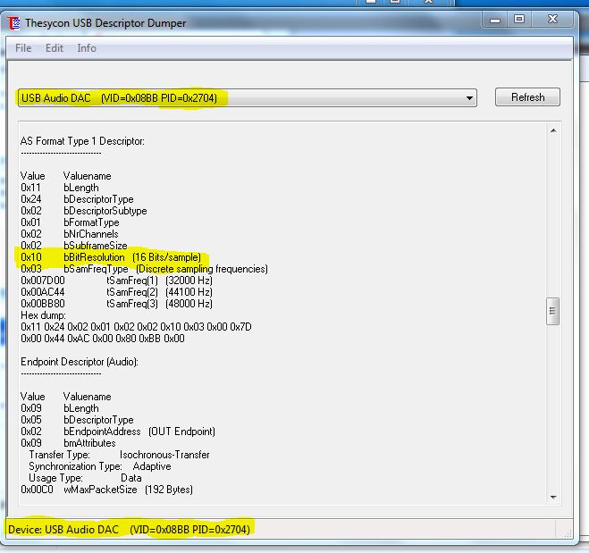

That is a Peachtree Nova. according to speccs 24/96. personally i am wondering if the USB Audio DAC driver from microsoft (Win7) is capable to talk with de DAC. Whenever i want to play 24 bit files i get "check DAC settings" popups and no playing. On the other hand when i play from foobar it does work. and by the way Peter, is it common to set DAC Settings according to the input files? I'd rather set them once corresponding to the DAC machine specs.

« Reply #4 on: August 25, 2012, 10:03:06 pm »
Open the attachment....This is the standard win7 USB audio DAC driver. would that mean that i can only use the s/pdif connection to the dac if i want to play 24 bit files?

« Reply #5 on: August 26, 2012, 08:24:10 am »
As far as I can tell, it can have 16/48 max for input over USB. But I even wonder whether it can take 24/96 over coax (SPDIF).
