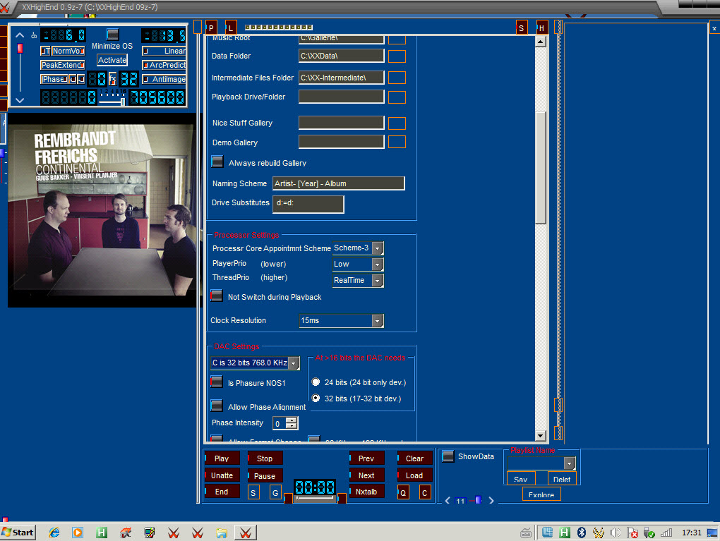

In version 09z-7 I have the situation that XX in every playlist suddenly stops playing somewhere in a track without an (error) message. It happens mostly between track two and five. I have changed a lot of things in an attemp to solve this problem e.g. changing memory types: SG,M,MC/Changing SFS from 60 to 150....... /Changing Q1 values/Changing the resolution to 1024x...... (yes, yes, I'm now using a 17" screen these day's). Lowering Video RAM in Bios,..... all in unattended mode. I can't find a clue to change this behavior.
In version 09z-6 I had a stable situation SFS 150, Q1=30, Memory Type:SG Unattended.
I'll hope you have a solution for me.
Regards Johan

Hey Johan,
Well, the first question arises : are you properly Activated. If you think you are, can you please post a screenshot of the proof of that ?
From there we will see further.
Btw, test this (stopping behavior) not with Phase Alignment engaged !)

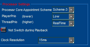

« Reply #2 on: August 23, 2012, 05:42:09 pm »
...........please post a screenshot of the proof of that ?
Unattended works ok.

« Reply #4 on: August 25, 2012, 09:57:17 am »
After a new activation all works ok! Inclusive the red border around the wallpaper. Thanks for the great job you did with the release of 7!
