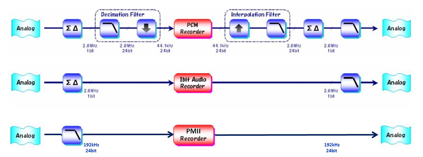

Jud, not sure if this will help, but here's my modified version of a diagram originally posted in the A. Koch paper.
The top process is what 99.9% of people are experiencing. And the 'killers' here are the DSD-to-PCM conversion in the ADC and the PCM-to-DSD conversion in the DAC.

Yes, this is the diagram I've seen, and it matches stuff I've read also.  But are the conversion from DSD to PCM in A/D on the chart that you've described as "killer," and the one available in DSD mixing of which Peter says "let's say this is harmless" the same (type of) process?
I'm trying to get a start on figuring out if there is a devil in the details here....
