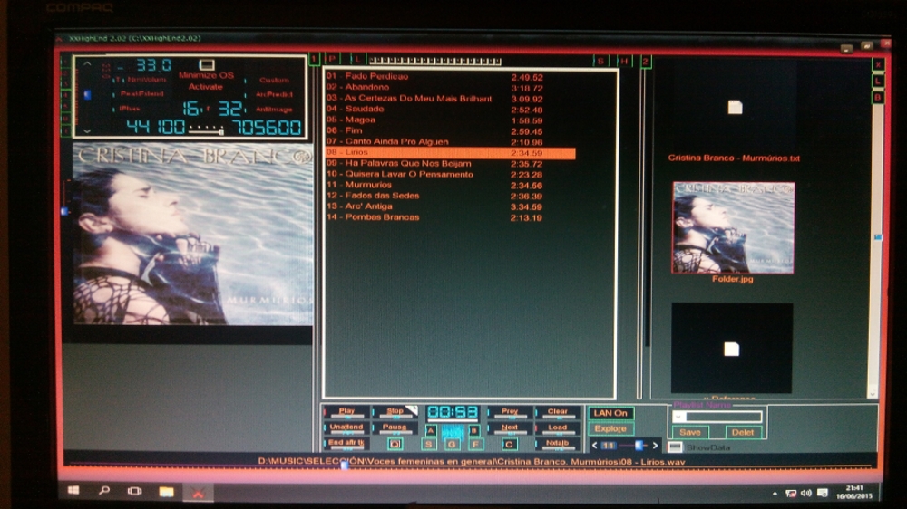

Thanks for the help Peter, it took me a while but the popups were gone. I uninstalled/reinstalled the OCX although I'm not sure if it was absolutely necessary. Later I played for a while with the Skings settings and the result looks pretty good to me. The size and resolution of my screen does not allow the perfect shape of images but I think itīs good enough.

« Reply #3 on: June 18, 2015, 07:59:09 am »
Hi Juan,
You may not need or want help on this but ... do you mean that the aspect ratio is not right now ?
It is a bit hard for me to imagine what could be wrong hence it should be possible to make it OK.
So is it the aspect ratio you are referring to ?
« Reply #4 on: June 18, 2015, 03:25:54 pm »
Hi Juan,
Peter, Iīm happy to help, as always, if I know how. The recommended resolution of my monitor is 1366 x 768 - 60Hz and I canīt find that resolution in W10 nor in XXHE or how to make images without lengthening or stretching it a bit. Probably it is possible to do it correctly but I donīt know how, to tell you the truth, so far I always have had clicked the "Donīt do anything with Coverart" button. It is now that Iīm experimenting with it, so Iīm a novice  Happy
« Reply #5 on: June 19, 2015, 08:05:38 am »
Juan,
W10 hardly contains drivers at the moment. However, you may put in your own. So for example, if you have an nVidia video card you can download drivers for that and install them. But possibly this is too obvious to be the problem ?
« Reply #6 on: June 19, 2015, 08:36:03 am »
