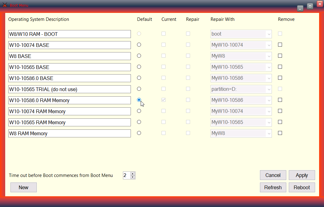

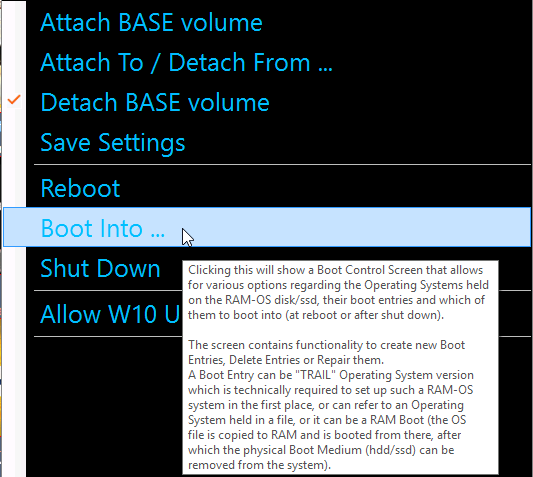

From here on you are going to choose what your first real RAM-OS boot is going to be. Thus, is that e.g. 10586(.0) then you are going to boot into that OS. It goes like this (start XXHighEnd (2.05 is installed in there) and) :
RightClick the Stop Button. Then :
Choose Boot Into. Then :
Select the OS you want to boot into 10586 in our example).
Notice that here it shows that 10586 is the current Boot, but in your (first Boot) case it will show 10565.
When you have done this, first click the Apply button (down-right corner) and after that click the Reboot button.
With a bit of luck, you will end up with Windows 10 Build 10586.0 running.

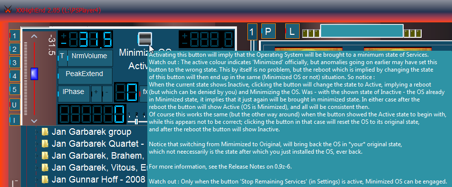

When all is set (up) you can freely boot into Minimized OS.
Just the procedure as you are used to.
Watch out : Booting from Normal OS to MinOS (or the other way around) normall boots into the same OS.
BUT
Do not attempt such switching from a RAM-booted OS because the data registering for that will get lost (because it will be written to RAM only).
When your 10586.0 pops up again it will show that you're in MinOS with the procedure as usual.

Once in MinOS you can decide to try a RAM boot, of that OS you now "installed" in MinOS indeed. So notice :
What you have done at this moment is preparing an OS for MinOS in permanent storage (which the the RAM-OS disk). So in our example this is 10586.0. If we now do this :
... do not forget to click Apply and then Reboot, the harddisk image is going to be copied to memory (RAM) and from there it is booted.
