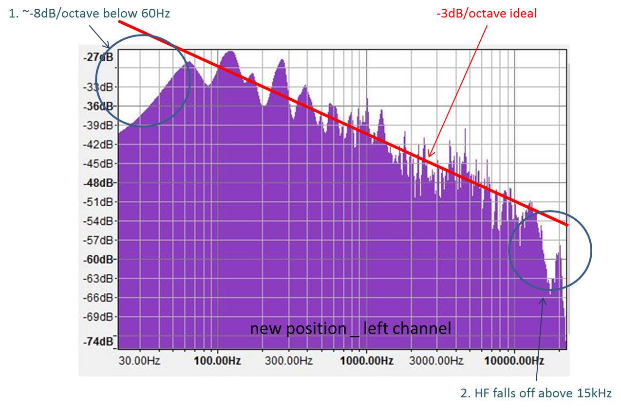

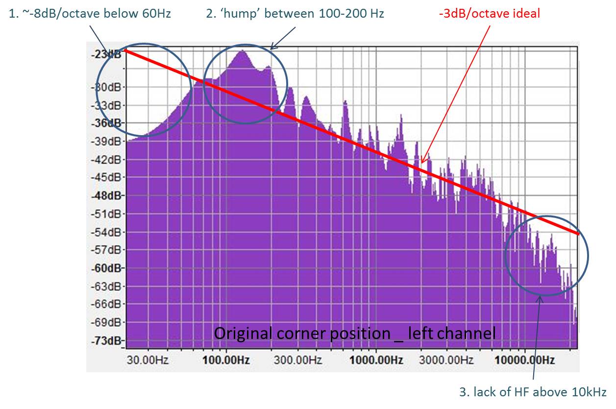

I decided to take a few measurements. The obvious tool would be REW, which I've used in the past. But I wanted to use the system exactly as it is (XX -> NOS1 -> BD amps -> Anima speakers), and not mess around switching gear. So, I decided to simply play a pink noise signal and capture the speaker output at the listening position with a measurement mic. The charts below show the following:

2. The captured signal, with the original speaker position (placed right in the corner).
- ~-8dB/octave roll-off below 60Hz
- 'hump' between 100-200Hz
- lack of HF above 10kHz
- matches my comment, "If I adjust them so that this LF is more pronounced, the mid-lows/upper-bass seem too prominent - vocals become unrealistically husky."

4. What I actually did: moved the speakers away from corner, and reduced the mid/high level. (This no doubt reduces the overall sensitivity of the speakers, and probably necessitates the use of a reasonably powerful amp.)
- ~-8dB/octave roll-off below 60Hz remains
- 'hump' between 100-200Hz now elimated
- HF now drops away above 15kHz
The sound is now substantially better balanced with the new speaker placement. However, there's still the unavoidable roll-off below 60Hz. (Just to put this is context though - with the Orelos, I had a dip of 25dB at 50Hz in this same room!) I'm going to see how I go before I start thinking about what to do (if anything).

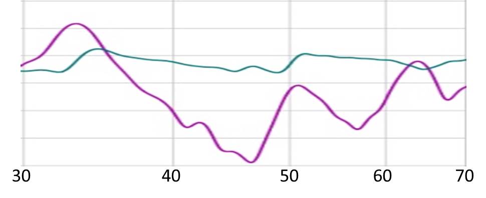

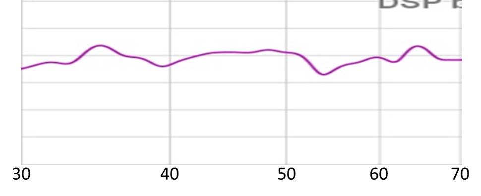

Of course, having the DSP in the LF of the Orelos means you have so much more flexibility than I have with my current speakers. I used the DSP in the Orelos to overcome the dip I was experiencing in the LF (see attached).
Pic 1 - Response from 30Hz to 70Hz with the mic placed just in front of the speaker vs. at the listening position. There was a 25dB dip between 65-35Hz at the listening position.
Pic 2 - Response at the listening position with DSP. Very similar to that with mic placed in front of speaker.
But I have to say that correcting for such a large dip with DSP came at a cost, and I reverted back to the original settings after a while.
