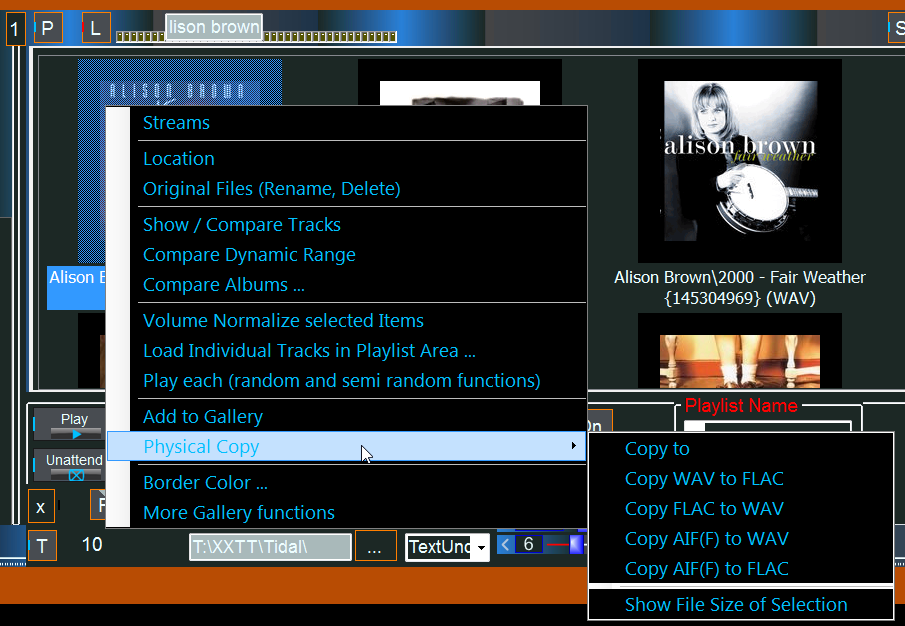

« Reply #4 on: October 07, 2021, 04:00:32 am »
Start with RightClick on the Album (Library Area).
