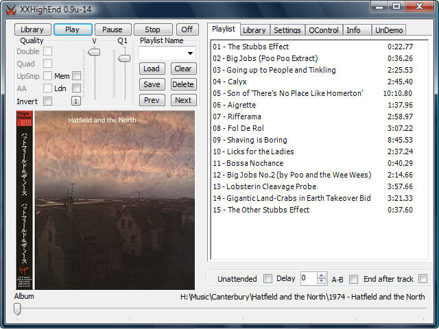

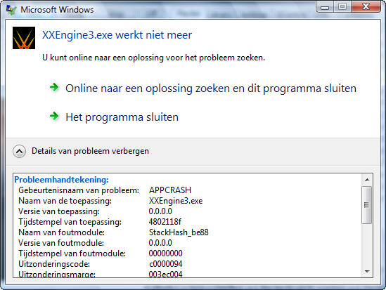

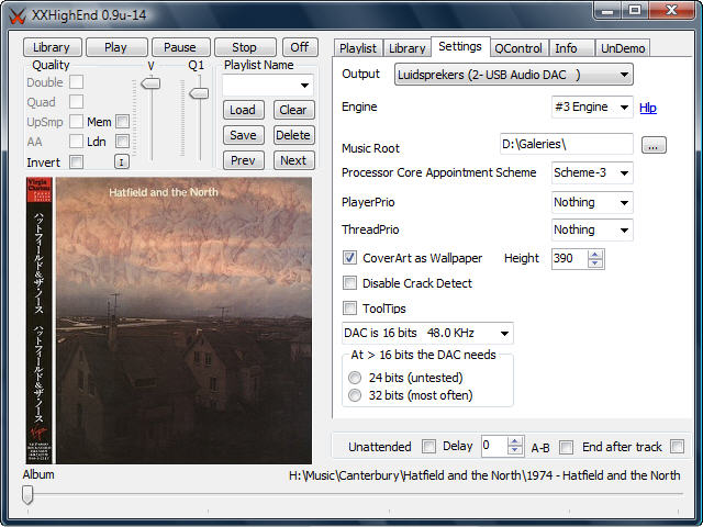

........during the load of a next track the Q1 setting is set to 14. After that next track commences playing it is reset to you original setting.
The lowest possible value of Q1 is 21 in mine configuration. Your solution of incrementing Q1 to 14 is causing an Appcrash error in XXHighEnd in every track. When i change Q1 to e.g. 5, all works well without an error. Suggestion, only an increment when Q1<14?!?
Johan

« Reply #2 on: April 14, 2008, 10:18:07 pm »
Also Q1 at -2 does not work. Meaning play with Schema 3 or 4.

The bug as announced by Johan has been solved in 0.9u-14a.
The problem itself (hiccups for some) has not been colved by this. sorry
