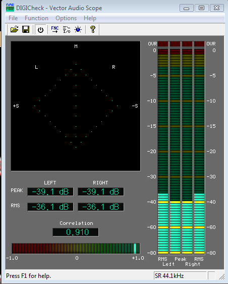

« Reply #2 on: March 06, 2009, 06:32:43 pm »
At last got to this (my Fireface is not connected by standard anymore).
Well, nothing seems wrong to me. Not by listening either.
I checked all samplerates including the Invert versions of it.
Did you find anyhthing additionally ?
