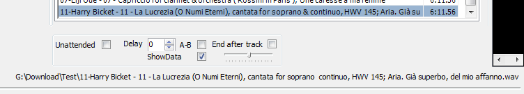

just checked that the error with unicode track happens always in the following situation.
1. You have a CD that contains such tracks, my example is :
Eiji Oue, Casa Guidi, Reference Recordings CD
2. You add the whole CD to the playlist area
3. You play the 6th tracks - it contains some French characters
4. You ship to the next one (Nt button)
5. You receive the screen below:
6. You click OK, then you see another screen:
Is this a problem with DOS8.3 ?
Best regards
Jarek

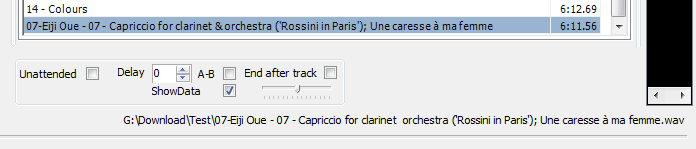

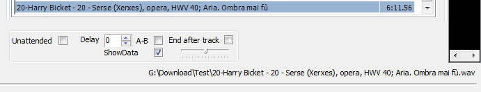

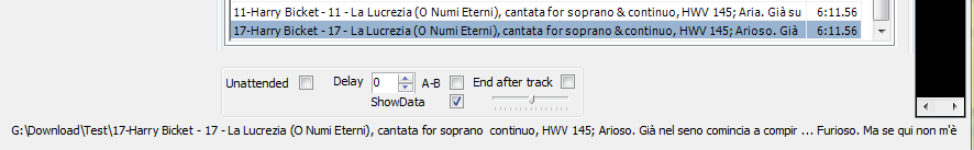

The 4 problematic sample titles are:
11-Harry Bicket - 11 - La Lucrezia (O Numi Eterni), cantata for soprano & continuo, HWV 145; Aria. Già superbo, del mio affanno
07-Eiji Oue - 07 - Capriccio for clarinet & orchestra ('Rossini in Paris'); Une caresse à ma femme
17-Harry Bicket - 17 - La Lucrezia (O Numi Eterni), cantata for soprano & continuo, HWV 145; Arioso. Già nel seno comincia a compir ... Furioso. Ma se qui non m'è dato
20-Harry Bicket - 20 - Serse (Xerxes), opera, HWV 40; Aria. Ombra mai fù

This is not ';' character.
But if you rename the track:
to
07-Eiji Oue - 07 - Capriccio for clarinet & orchestra ('Rossini in Paris'); Une caresse a ma femme
changing only one letter from 'à' to 'a' it plays well.
So summing things up, the characters: à and ù are the problem.
Try it for yourself in your system. Rename any track on the disk aby adding 'à' and reload it to playlist.
Best regards
Jarek

« Reply #14 on: November 27, 2009, 09:50:37 am »
Dear Jarek,
Ok, just did. They all play. I really did ALL I could think of to let it go wrong, but I can't.
Now, where it actually goes wrong at your side is at the FLAC conversion (to WAV). You didn't replace the supplied FLAC.exe with one of another version, did you ?
There is one other option I see (very very far) and that this is an HDCD recording. How that can be related to the naming of the file, beats me, so that probably isn't it either. But, HDCD itself might be something FLAC tripples over ?
Otherwise it must be something special to your system, related to FLAC. I can't tell how, but I guess it can. So, what happens is that the FLAC conversion (done by FLAC.exe) just doesn't produce output. Similar would happen when no (begin/end) quotes are supplied to a long file name, and FLAC just doesn't find the input file. So, it is my estimate that FLAC can't find the input file because of those characters ... in your case only. Keep in mind : you are the only one, or otherwise I would have heard it from others.
