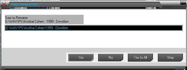

  • Music paths can now be Mass Renamed by means of the new "Mass Rename Original Paths" option in the Context Menu on the Library Area Coverart, and it can be done by means of a Naming Scheme which can be given. In the Settings Area your default Naming Scheme can be registered (Data Locations section).
    Optionally the year of release can be obtained from Amazon, but notice that this doesn't work well for CD albums which were only recently put to CD, while e.g. a vinyl version was released 30 years ago (the CD release date will be reported by Amazon).
    It is the strong advise that paths are renamed piece by piece, although "doing them all" is just allowed. Please note that you can't hold your humble developer responseable for messing up your folder structure, which just may happen because of *your* unexpected (strange Happy) structure. So, be careful !!
    Important : Just before submitting this version it appeared that this Rename function does not properly work through the connected Galleries. IOW, for now only use this when no Galleries have been drawn from the paths concerned !

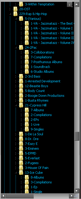

    Expand to Artist folders
    This is a rather powerful function, because it opens the selected node/folder "intelligently" up to the Artist level when you have separate folders for artist like :
    \Jazz\Ahmad Jamal\
    \Jazz\Al Di Meola\
    This allows you to select the Artist (or main group, see picture) more easily while otherwise you'd have to open en close nodes endlessly.
    If you organized everything in a complete flat fashion this function won't help you much because there's nothing to collapse or open except the music folder itself.
    Note : the earlier mentioned Mass Rename function can help you to reorganize from flat (like Deep Pruple - Strombringer) to more hierachical (Deep Purple\Stormbringer).

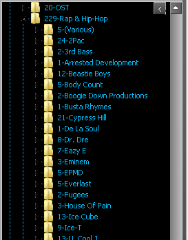

    Close to folder
    This is another means of closing a node; below it was used on Rap & Hip-Hop and while when that node would normally close down completely when the arrow left to the node is clicked, now it shows its immediate children. Also compare with the previous picture.
    All 'n all these functions were made for those who ultimately make nice hierarchies of things which becomes quite unmanageable because of the depth. Hopefully this helps with this way of working.
