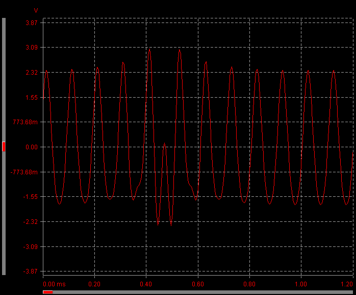

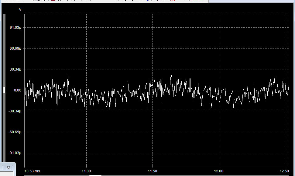

Since I was measuring anyway, here's a small bonus (also for others - see more below) for hopefully better insight :
Although this is a measurement on the outputs of the NOS1, it nicely can show what I meant with jitter because of the 0-1's hammered upon by noise.
You see a slight wave, and just suppose the 11.00ms and 11.50ms marks are to be the "trigger points" for my before-mentioned voltage (detected) change. Try to envision that these both marks are the official time points where the 1's and 0' need to flip. And, with some imagination you can see that the wave has its peaks at 10.75ms and 11.75ms and its dips at 11.23 and 12.25ms (the peaks work out better than the dips here).
Now, because of the noise this will never work out. But now compare with this picture (but do NOT take into account the high peaks you see - they are unrelated to the story) :
So, envisioning those peaks not being there, it is clear that at 0.45ms or so the voltage goes through zero and at ~ 0.95ms it goes up. Same at 1.45ms and 1.95ms.
If you compare the both scales you can see that peak to peak noise in the first picture is around 55uV and in the second picture it is around 40uV.
Because of the fewer noise in the second picture, that will imply less jitter (well, the first picture actually has no chance).

So, this is 120dBFS of attenuation of a 1000Hz test signal, and attenuate 6dBFS more and the "wave" will disappear in the height of the noise. Notice that attenuating 6dBFS means the shown peak-peak voltage will be divided by two. So, the 55uV you see will become 22.5uV and it is not so difficult to see how that will be as high (or less high) than the high frequency noise. Gone is our signal.
So I say it again : no one will tell you that a 24 bit DAC can resolve to 24 bits, and the unlinearity of the D/A chips is blamed.
But is it ?
Look again at the second picture.
The fun ? this is a 20 bit DAC (btw, I suspect the Metrums are). This too shows 120dBFS attenuation, but the last bit keeps on toggling (goes from 1 to 0 at the interval of the same 1000Hz signal). And to keep in mind : a 20bit DAC per se can not resolve more than 120dB (dynamic range can not be larger). So ...
I don't think this has been shown before anywhere, but while the 24 bit DAC won't resolve more because the signal will be burried in the noise, it is clear that there's still a nice sine visible, which is only made aware when it is compared to the 20bit DAC which outputs a square there (forget the peaks you see !). Aha ...
And so, at loud levels (think about an amplifier with a gain of 80(dB) or so), these both signals compare as :
24 bit DAC will exhibit a sine with some distortion which will be fairly OK;
20 bit DAC will exhibit a nasty tone because a square contains all frequencies in the world.
All right. I went fairly much off topic, but it should show you that here too noise is important and mind you, the few uV of noise I show here really (really !) is not much. But still it is important. For my second subject of this post theoretically, but for jitter vastly.

« Reply #11 on: April 16, 2013, 02:43:15 pm »
I found two comparable picture of the same "pulse" signal, the first through Arc Prediction, the second through a common reconstruction filter.
Notice the trick here, where the pulses are not evenly spaced. Now see how that chokes the common filter. Also notice the general wave you see in the second picture (look at the peaks) and see how that is a slow frequency within itself. All not good ...

Those last two Dirac pulse reconstruction graphs are just really, really nice at bringing home your point.
