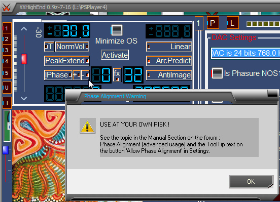

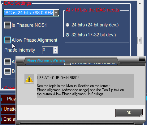

This button (Red is active) is your extra protection for when it is clear that you can not use Phase Alignment. This way you can not click this by accident :
This really activates it as long as the digital output volume is less than -9dBFS (so, towards the -144).

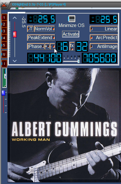

First off, it won't work with (XXHighEnd's !) Digital Attenuation of less than 9.5dBFS. So, the Digital Volume of XXHighEnd *has* to be used. Otherwise it won't engage.
Note : When it is engaged, this can be seen on the Coverart Wallpaper by the denotation of ** around the Absolute Phase indicator. So, this will show *~* for Normal Phase and *I* for Inverted Absolute Phase. When _~_ or _I_ shows, it did *not* engage. And notice that the -9dBFS we talk about, incorporates the Volume Normalization. So, when you set the Digital Volume to -12dBFS but Volume Normalization made -6dBFS of that, Phase Alignment will not engage (without further notice, but watch the Coverart WallPaper).

The IPhase button is accompanied by a small + and - (plus and minus) button. Clicking either of these activates Phase Alignment; Remember, whether it really engages depends on the Digital Volume (see above).
The ToolTips on these buttons will tell you when to use which as well as it will tell about all the combinations which theoretically exist. Quite many, and all will sound different. Which is right depends on your system, so take notice of that. But generally when you receive the best sound from Normal Phase, the minus button is yours. And the other way around, when your normal setting is Inverted Absolute Phase, the plus button is the one you'd want.

For highly experimental usage, the Settings contain a "Phase Strength" field. This is filled with 0 by default, and it should stay like that. However, it is there for a reason, and it can be set to 1, 2 or 3. It is not even advised to try it, but since the field is in there you will at some stage (but seriously, better not try it).
What will happen is that indeed the strength of this application is going to be higher with no single technical reason of how it can sound better. And really, it should be worse. However, this now acts as a smoothener for something we could call "over stressed systems"; Hard to explain, but look at it as amplifiers which are way out of control of the woofers, and this now will soften that. So, a really bassy system may get better of this after all. May, because it really will be a strange thing, and it virtually anticipates on things being fairly wrong in the first place, so the correction is (to be) inappropriate.
