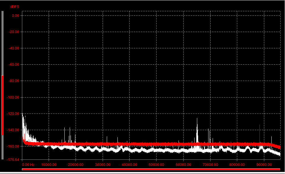

Here are two screenshots of the very low power supply noise as how it can be achieved today with the NOS1 (yours too). First screenshot shows the positive rail, second one shows the negative rail.
Watch out : the red trace is the normal system output noise (measured at the output terminals) and the white trace is the supply noise (in this case to the DAC board).
The supply noise (thus white trace) was measured under normal load (of in this case the DAC board).
For anomalies seen, note that this comes from a test DAC full with measurement wires (antennas).
For those really interested, mind the negative rail which is as good as the positive rail. This is not so easy to achieve.
Positive rail
Negative rail
Separate supplies are provided to a. the DAC board (pos/neg), b. the gain stage (pos/neg), c. the clock section (pos) and d. the USB interface (pos).

« Reply #2 on: May 11, 2014, 12:20:58 pm »
Hey Anthony,
PS:  Great to see this coming out!!
Haha, yes, you know I was working on that (with you working in similar areas). But yes, after what ? 3 or 4 months on this little subject only and two versions of it, it worked out completely as expected;
I honestly don't recall what the previous measurements were (never took screenshots of that either) but depending on where it was measured (USB, clocks themselves, DAC sestion postitive vs. negative) I recall something like 10s of mV (USB could have been over 100mv) to 3mV or so. Don't pin me down on this.
(I could measure an "old" NOS1 though)
This now all is under 2uV up to a theoretical 1.5uV RMS. "Theoretical" because the measurement wires (antenneas) catch 50Hz (as the mains is over here) which make it wobble somewhat (you can see that in the left hand side of the screenshots). Not sure how to measre the supply noise without the measurement wires. innocent (all is on PCBs).
Also see below snapshot. White trace again is the supply noise ves red the normal output. You can see the "wobbling" which without measurement wires is not there. Peak to peak of the white trace is around 7uV.
Btw, I am not sure whether you meant this kind of improvement ?

The other thing that has probably happened with the use of cutting edge voltage regulators is that the total bandwidth of the noise that you have under control is much greater now as well...I notice that the two graphs from the first post go out to 90MHz with those excellent results.
« Reply #5 on: May 11, 2014, 01:32:44 pm »
Haha, maybe, but then I need to hook up another analyzer first. So, 96 KHz this shows (but there is no reason for ultra high frequency spuria unless sourced from my own house (like you see my ever and old PWM heating pump close to 18KHz).

« Reply #7 on: May 11, 2014, 02:17:14 pm »
Sorry, thought a "K" and typed an "M".

« Reply #8 on: May 16, 2014, 03:12:54 am »
What is your FS set to in these measurements? (might be more meaningful for comparisons in say dBV)
What happens to the noise floor when you put a test tone say 1kHz through rather than silence?
Chris
« Reply #9 on: May 16, 2014, 07:43:24 am »
Hi Chris,
I always measure in dBFS; I could easily look if I would be on location which I am not at this moment. But easy enough : full scale is just that for signal (so -0dBFS) and what you see is relative to that. -0dBFS in my case is 2.25VRMS.
Let me know if you really still need to know the dBV (or any unit for that matter).
Totally nothing zilch (signal at -0dBFS). I checked that as the first. Wink Nothing "moves" anywhere. Uhm, for the supply noise (white trace) that is. Checked 18KHz as well because that could be better visible above the field because of the more "wild" area at the left hand side (1KHz). But still nothing.

« Reply #10 on: May 16, 2014, 10:40:41 am »
No need to worry about dBV, you've given the important bit of missing info, 2.25V = 0dBFS was all I really needed to convert the above numbers to absolute voltages. I was more interested in what happens to red plot when signal plays, wouldn't expect white to change. Was trying to compare this with the measurements earlier this year that you showed in the NOS1-USB thread.
Chris
« Reply #11 on: May 16, 2014, 11:06:40 am »
Chris, Ah. I think I told (somewhere) that nothing much changed to that except for a small 1dB difference for the better. This is when idle.
When playing 16 bit material the noise or that (red trace) rises with 20dB which is inherent to the upsampling and say "the quantization noise". This goes along with the level of the output signal and when attenuated 20dBFS the output noise is at the idle level (see pictures).
Such thing does not happen at all with 24 bit material (so also not 44100). Then output noise then stays at the idle level also at -0dBFS.
Additionally - and just saying - the noise occurring with 16 bit material can digitally be filtered out (in advance of the DAC, thus in-PC). This of course tells that indeed it is not related to the electronics - also not the D/A chips or anything in that area; it's just the 16 bits (actually also without upsampling but the main point is that the upsampling which also expands to 24 bits can not cover for that phenomenon).
