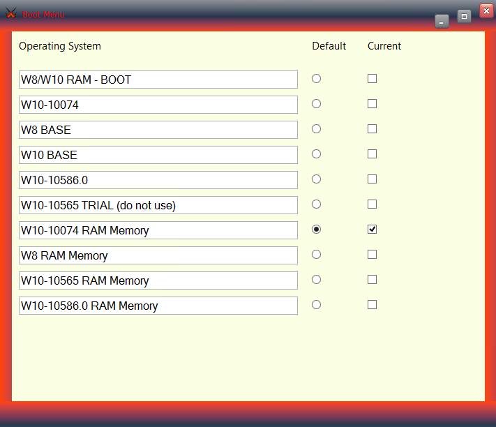

Otherwise I like "one procedure for all" because of all the (quite ad-hoc) boot situations I am working on right now (See below for what's conincidentally on my screen - XXHighEnd shows 10 boots to choose from - work in progress).
