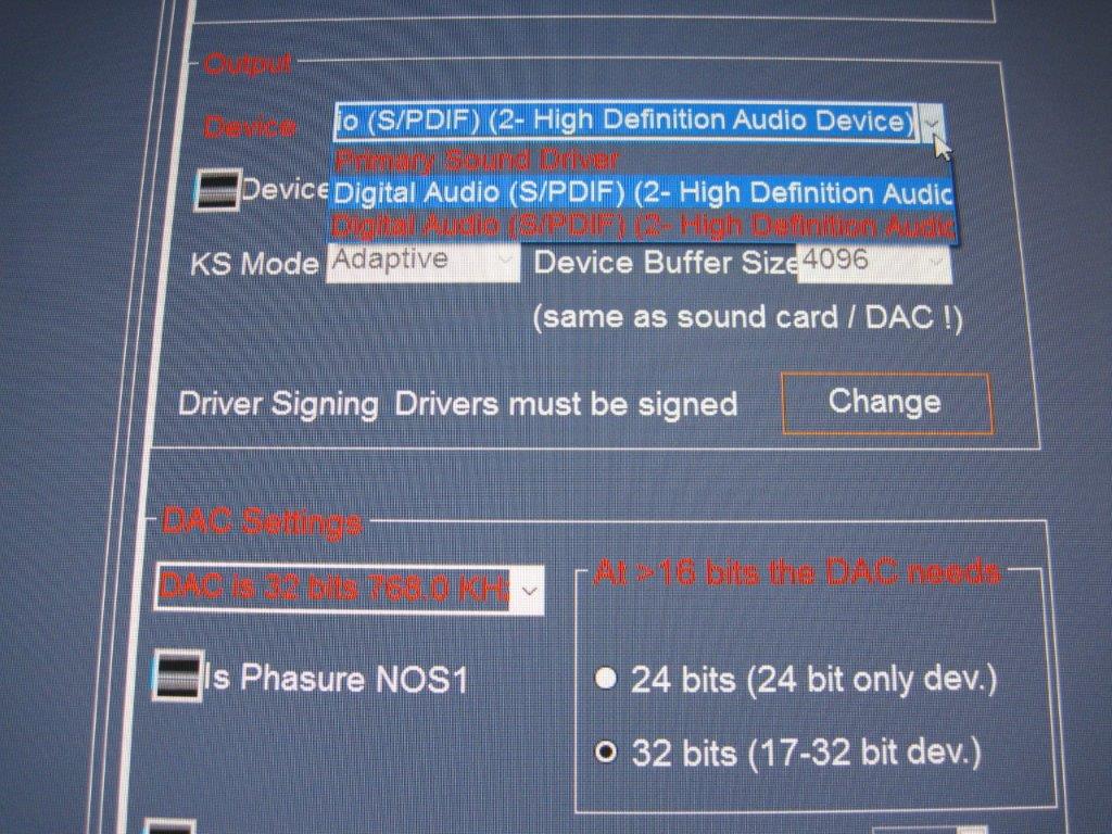

Ok, in output section, after Refresh I got what you can see at attachment. No help, but it's not clear what I can get with this function...

« Reply #5 on: December 27, 2016, 12:18:22 pm »
Press Change, reboot one time, press Refresh and look for the text "need not be Signed".
But apply that Reboot ! And then only look (via Refresh), and do not change again !!

« Reply #6 on: December 27, 2016, 12:59:15 pm »
Ok, done. Now I can see a question mark after driver signing. Pressing refresh I get: drivers need not be signed.
But under device I still don't find the right one. And still under device manager there is the Yellow triangle due to digital signature not verified. Error 52
