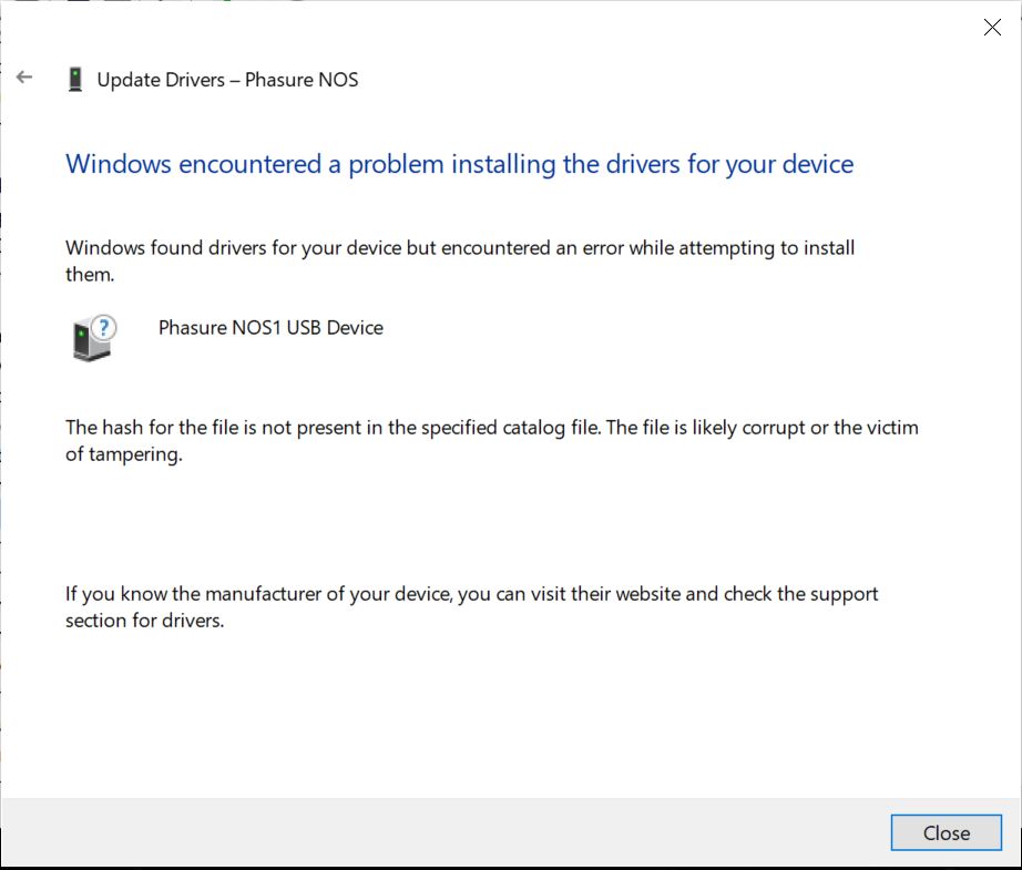

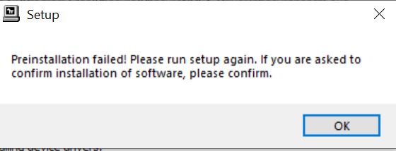

I'm trying to load the NOS1 driver onto my work PC (which has W10 updates set to automatic). When I use the 'setup' in the 'Phasure_NOS1_v1.0.4b_768_setup_production' folder, I get the first error. If I use 'update driver' in Device Manager, I get the second error.
Any ideas?

« Reply #1 on: September 11, 2020, 05:41:25 pm »
Hi Mani - this is what I just sent you by email (I surely received yours (twice)) :
Although your screenshots are barely readable, it is my estimate that this is about the Driver Signing not being shut off. This can be done n XXHE settings, remember ?
After changing the setting, reboot (IIRC).
But in here (forum) I am able to read what's in your screenshots and now I don't know. The message about the catalog file and the tampering is unknown to me, although I'd understand what it means.
Try the Signing thing anyway, and let me know whether it helps. By forum would be the best, assumed others may run into this as well ?

The message "The hash file is not present in the specified catalog file" sounds a bit more 'serious' that simply disabling driver signing...

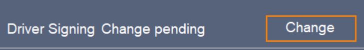

OK, I've just tried to install the NOS1 driver on my music server, which has XX installed (for Tidal).
1. Click on Refresh button next to 'Driver Signing?' -> "Drivers must be signed"
2. Click on Change button & reboot
Install driver -> same error message as before
3. Start XX and click on Refresh button next to 'Driver Signing?' -> "Drivers must be signed"
(Driver signature verification doesn't seem to have been disabled.)
Any ideas?

Mani, what about considering the message to be true and that somehow the copying from whatever source prevented a file to come along ? Or, that the unzipping of the original zip file (I guess you have that) disallows that file(s) ?
As we know, similar can happen with the install of XXHighEnd.
« Reply #5 on: September 12, 2020, 09:01:25 am »
Hi Peter, I've tried unzipping the original file, but I get the same error.
It's been a very long time since I last installed the NOS1 driver on a HDD because I've been using a RAM-OS disk with the driver pre-installed.
Could you email the 1.04b driver to me again just to eliminate the possibility of a corrupted file please? Thanks.
« Reply #6 on: September 12, 2020, 09:19:34 am »
Done.
But after unzipping, you still should compare the files (number of) with the contents of the zip I sent.
Check XXHighEnd for the Driver Signing still to be Off; All the Google finds still lead to that for this message (FWIW).
« Reply #7 on: September 12, 2020, 11:30:07 am »
Hey Peter, I don't think disabling driver signing in XX works. I did it through W10 startup (as explained here: https://windowsreport.com/driver-signature-enforcement-windows-10/) and I was able to install the driver. (I had to click on 'install anyway' a few times.)
Thanks for sending me the driver (was unnecessary in the end), and perhaps this may be helpful for anyone else attempting to install the driver on an updated W10 machine in the future.
