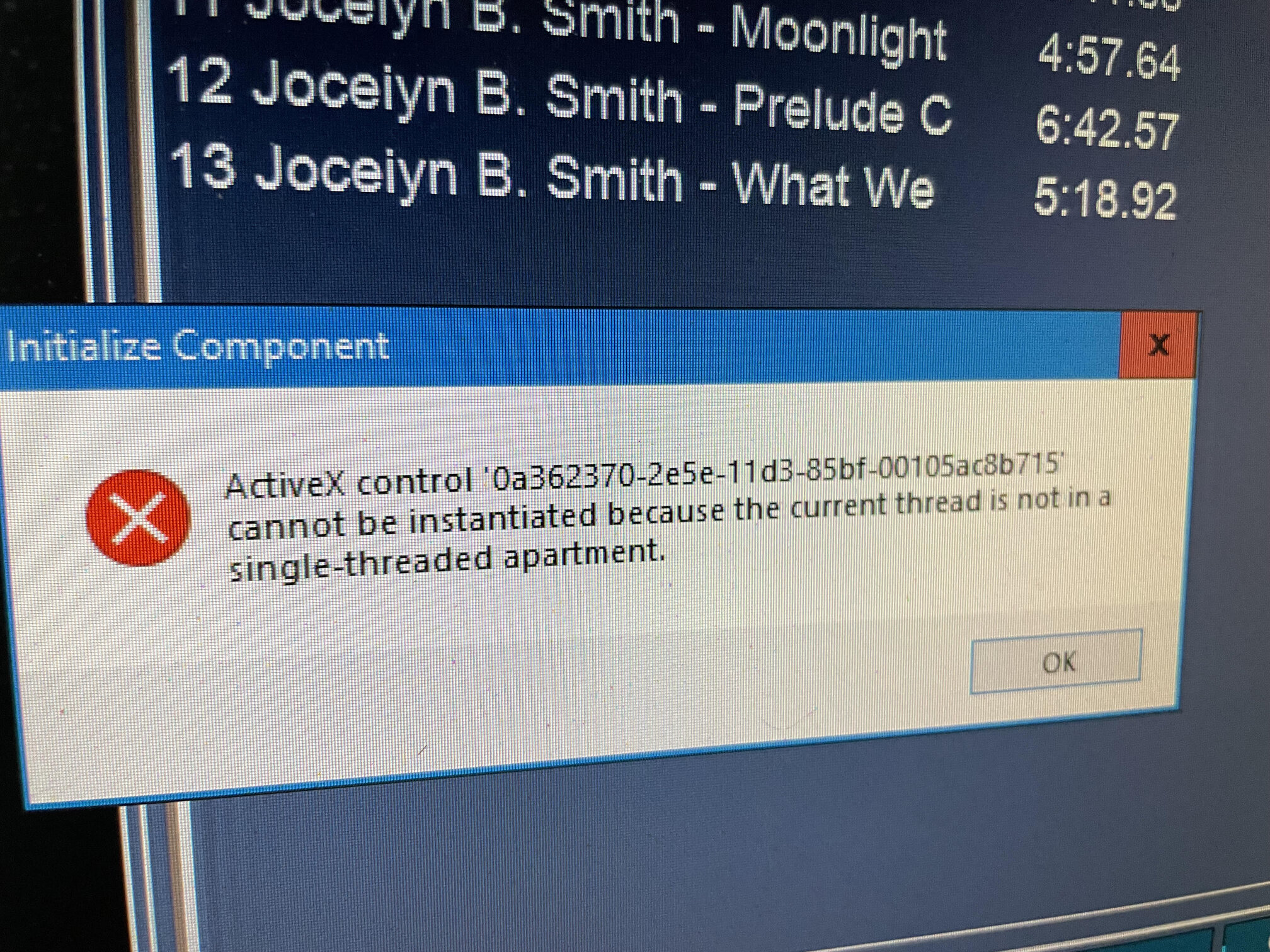

I am running into a problem. I have not yet activated but XXHighEnd always shut down by itself and pop up the message:
"ActiveX Control "....." cannot be instantiated because the current thread is not in a single-threaded apartment."
I am using Windows Server 2019 Core mode with AO3.
Your response will be highly appreciated.

« Reply #1 on: July 01, 2021, 05:57:33 pm »
Hey there vhs,
Well, not that I knew about this error, but it will only occur because of the demo version "quitting". So between 6 minutes and 30 minutes or so, the demo version shuts down automatically, and apparently there something goes wrong now. But it would have quitted anyway ...
Thank you very much for mentioning this and of course I am going to look into it !

I guess I find the culprit of that ActiveX error message.
As I am using dual Xeon Scalable 4214 (12cores) of my music server, I adjusted the CPU Affinities of "XXHighEnd.exe" & "XXEngine3.exe" to Core 24-47, which were 12 cores in total.
After I readjusted the CPU Affinities of the above two processes to Core 24-43, which were 10 cores in total, ActiveX error message had never popped up again.
Cheers.
« Reply #3 on: July 02, 2021, 06:01:17 am »
Interesting ...
I don't think you can tweak like that because XXHighEnd does similar itself. Additionally I never took into account 2 processors in the sense of the total core count emerging by that. I mean, 12 + 12 would be 24 and 24 cores are not supported as far as I recall (I could look into the program - haha). So for example, 12 would be supported, 16 would be, 20 would be, 28 would be, 32 would be, 40 would be. But not 24 because I never saw a(n interesting) processor with 24 cores.
I would not think that things error out because of this (but apparently it can ?) but at least SQ would not be as intended (processor tasks would overlap / be mixed while all should be dedicated (no taskswitching implied)).
I think it is good to know (as said) that XXHighEnd does these things itself, and that possibly this implies anomaly because of the two levels this now occurs. Thus, you do this by means of TaskManager, and XXHighEnd does this internally. I'd say this will overrule but ... how will this unroll the stack ? Think of you quitting XXHighEnd and all nicely being undone (this really is so). But if XXHighEnd bails out because of demo-end time, then I am not so sure. It could be a too hard-quit falling back to ? ... Your settings ? ... I just never thought about this. And thus :
Interesting ...
PS: And thinking some more ... The Demo version does not allow explicit Core Appointment (see the according field in Settings for that), BUT one scenario is set anyway. It can well be that at "bailing out" this is not sufficiently taken into account. "If Demo then Don't reset Appointments because no User Settings applied". And this all in the midst of quitting playback right where it is (doing its job), which is different from you stopping playback where all is reset (mind you, for the whole system, not only the two XX executables). So yea, the bailing out with playback going on may not do even anything about resetting Affinities ... (call that a bug).
