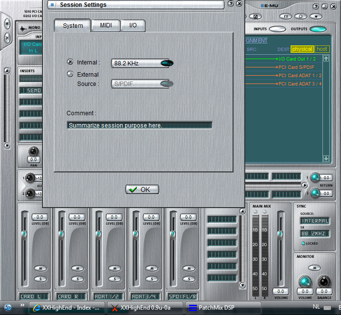

I have been playing around a bit..... I never could use the double function.... Until as you see below i set my EMU to 88.2 khz.... (Pic 1 en 2)
1: Is that ok by you? I mean is that right or can i do something else for the better?
2: Does it have to show in XX also? (see pic 3) Because it does not..
I am sorry but this Bytes/Khz/and Bits thing is rather confusing for me.... unhappy Happy
And maybe i have to leave it just to plane 16/44.1..... ( For now )
Grtzzzz

« Reply #5 on: February 20, 2008, 06:37:46 pm »
For me it's confusing just the same Gerard.
When you ticked Double and it playes, you should be fine. Also, that info screen (3rd) shows the native file data.
Whether this is better for SQ is up to you. YMMV here. But you can try now ! Happy

« Reply #7 on: April 10, 2008, 02:57:00 pm »
Sinds the new driver of my EMU makes that i cannot double anymore i have a question. In the Settings area of XX i can find 44.1/48/96.192
In the settings from my EMU i can find these. But I can also click 88.2 wich i cannot find in XX.
Why is that or is that someting that will be added?
« Reply #8 on: April 10, 2008, 04:45:39 pm »
The settings in XX are about "logical" maximum rates. And since I don't think a DAC will exist that has a maximum of 88.2 (because then it will do 96 as well), 88.2 is not there. Same for 176400.
On that matter I think that any DAC that can do 44.1 will do 48 as well, although I am not sure about that.
352800 is a different one, because this is a kind of official standard, and DACs may be produced to that standard. Theoretically 384000 could exist as a double of 192000, but I don't think it does and will.
Note that the DAC Is settings are used for "self protection", and sometimes to make decisions on how to behave (like playing 352800 on a 192000 DAC will downsample).
When you can only choose 96 with soundcard settings of 88.2 - and play 88.2 - this really does nothing. All behaves as if you chose 88.2.
I hope it is clear a bit ...
