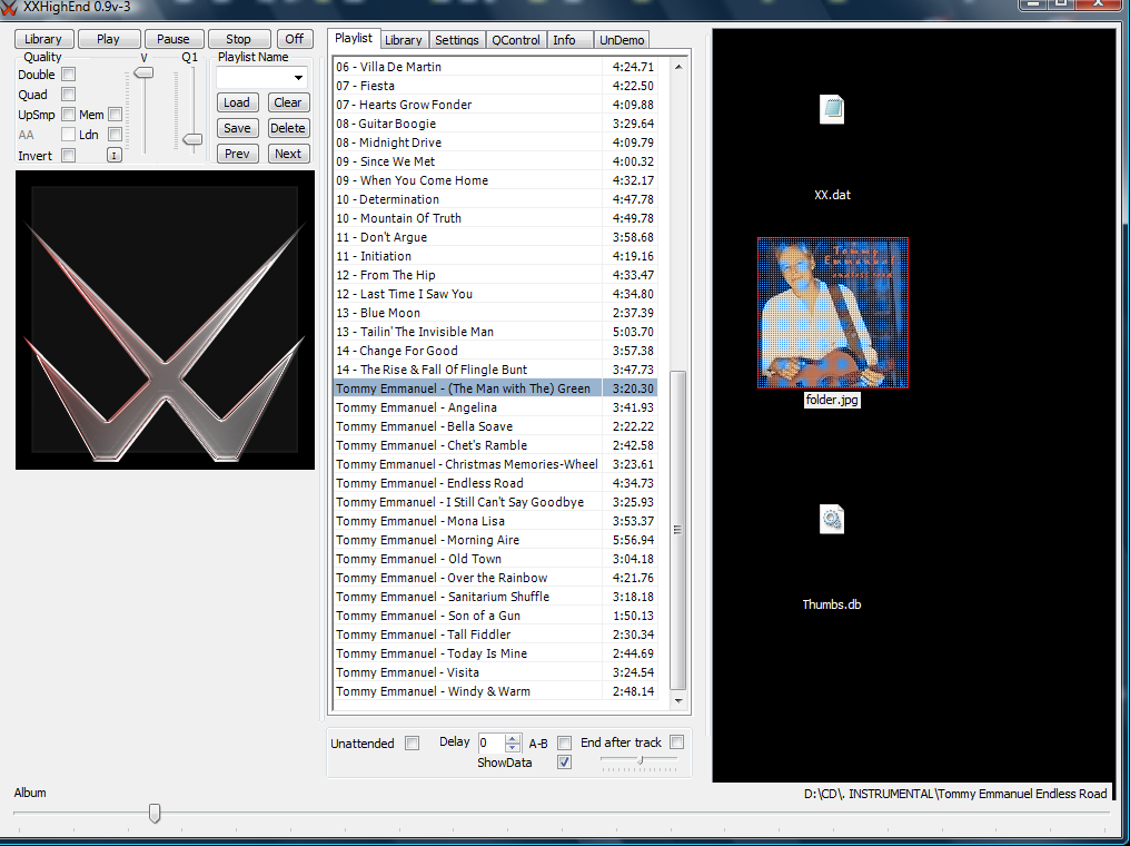

1: The covertart at the most left does not show anymore... I tried severall cd's. In all the folders folder.jpg is the name of the coverart. Maybe the capital F??

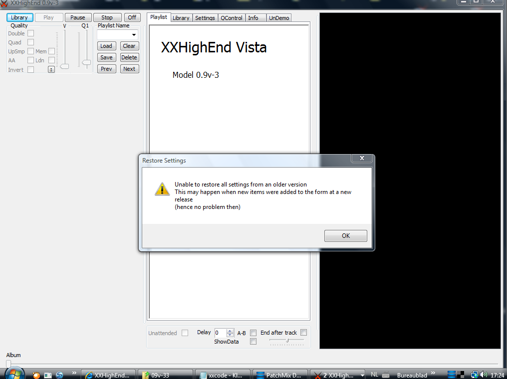

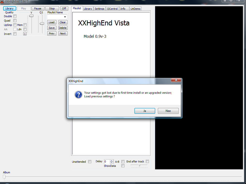

2: Every time i restart the player all the settings are lost. And i have to set it again.
Thanx

About the coverart : Not sure, but something doesn't look right. I mean, the XX.dat in the right pane ... where does it come from ? this looks like the Folder.jpg is in the XX data directory ?
About the Restore Settings ... looks unfamiliar to me too (that it keeps on doing this). Did you try to answer No at the first question ? (yes, you would loose the settings then).

I do not now what the xx.dat means. i have seen it before and i alway's thought it must be a hidden file or something that xx ad to the folder.
but now trying and opening the galery structure aswell the origin data maps they do not come up. And i forgot how i can show the hidden file's. When i open such a XX.dat with kladblok a whole other cd is written in there. And it looks strange but with every cd i try the pic below with the same cd and track is written in there.  wacko
Indeed answer No does the trick and the next time i am opening up XX that question is not asked anymore.

Gerard (I moved the subject to its own topic),
You must look at it the other way around : That XX.dat is allright, but somehow the program thinks your album is in the XXHighend folder.
Like you installed XX in the middle of the album structure ...
So, can you show me the folder structure (including the drive root) of this XX install ?
and show me that album in its structure as well ?
Something like this would be wrong :

Here's a little brainstorm (merely for myself) in order to find what's going on here. See the bottom under the double line for more to the point stuff.
I read this again, and I thought that at clarifying a bit from my side, you can better determine what is going on. scratching
The XX.dat is normal and it is used internally a.o. to keep track of what you played (in the end the data in that file goes to !Played.PLXX). FYI, this must go this strange way, because remember, Engine#3 is running (or can run if you want) completely on its own and it does not take care of playlists etc.; it just plays. yes
The XX.dat is held in your current XXHighEnd folder (not the by you appointed Data folder !), that is, I wouldn't know of a way to let it end up elsewhere.
One exception to this : when you'd be able (but are you ?) to start XX by means of file associations (double click on a music file from within Explorer), yes, then the XX.dat would end up in between the music data.
The latter not assumed, what you look at in the (right) CoverArt pane just *must* be the contents of your current XXHighEnd folder. Or at least, partly (for the XX.dat part). Why "partly" ?
... because the XX.dat can't be somewhere else than in the XXHighEnd folder, and because the Folder.jpg shouldn't be there.
The latter is a bit more difficult to interpret, because most probably it just *is not* there, but, what you see in that right pane is just everything XX found for coverart data. Btw, with richtclick on such an item - Show Location you can see where the files really are.
Generally you can say that XX looks for coverart for the current album in the folder of that album, one folder above it when it's a multi volume (the name of the album one folder up), and all the folders below the folder from the album. Knowing this, we now can look again at the structure I gave you :

Well, apart from nothing, I recall that I saw the XX.dat myself somewhere where it shouldn't be. And let's keep in mind : the XX.dat only should be in the current XXHighEnd folder, and nowhere else (also, XX so far never wrote anything to your precious source folders (but that will change in the next version haha), which I really wouldn't dare without telling). But ... it can well be that somewhere there's a mistake in the program ...
Ok, at this stage of my reasoning, I suddenly realize that XX.dat doesn't even exist anymore in the program. So, what you bump into (must be "here and there") is from a very old XXHighEnd version (November 2007 or earlier). So here we go ... the whole thing is unrelated, and the subject is invalidated.
Now I REALLY don't know.
The capital F doesn't matter (but I will look whether I made a mistake into that one).
Maybe it makes a difference when you tick Simple Search (Settings Area) ? It shouldn't matter, but at least then the only thing which is (and explicitly) looked for is folder.jpg, which also is equal to before 0.9v-2. When Simple Search is not ticked things are way more complicated and everything could go wrong ... weren't it that here I don't have a problem with it.
Gerard, forget about my earlier questions, but please try the Simple Search checkbox and let me know.

First sorry for not answer your last post... I have been busy with whole other things. And  not much time time play around with XX. blush1
Since v4 the coverart in the left panne started to work again.  Happy
