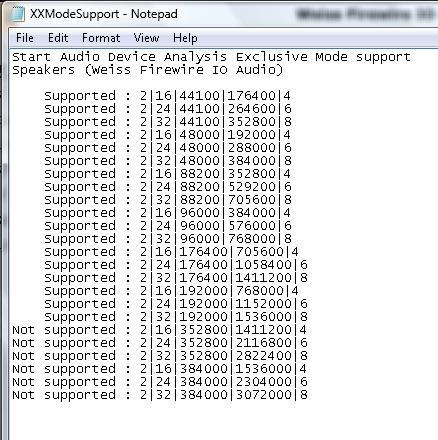

Peter, does this look right to you?
I'm connecting the Weiss AFI1 to my Esoteric D70 via single and dual AES/EBU cables.

Hi Mani, the only thing I like less is the "speakers".
Is it not working properly ?
« Reply #2 on: April 28, 2009, 10:02:39 am »
Peter, I think you have an older version of Vista, right? SP1 seems to assign 'Speakers' to the main channels of your soundcard/interface, whether you like it or not. This is true for all my 3 SP1 Vista PCs. But I'm sure that SP0 didn't do this.
The AFI1 seems to be working properly. I was just surprised, as I've never seen '24 bits supported' before. I'm taking this as a good sign, no?
