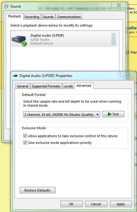

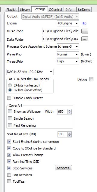

« Reply #6 on: May 27, 2009, 11:34:08 pm »
or just disable what you don't need, leaves you only with one device left,
 like in the pics thats the one to be chosen in xxhe.
see pics audio device must be the same
