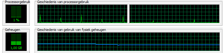

Are you 100% sure this isn't the case with each portion which is read into memory ? So, if you choose a soft track without much cymbals and drums (maybe piano or a bass only), set your Split File size to 12, use Double Arc Prediction then maybe each "few" seconds a tick can be heard. If you look to below picture, right before each spike in the left core occurs, the tick may be there. Now :
Whether you have this (per file portion) or not, what happens if you use Anti Imaging Upsampling ?
When you can admit it happens be file portion loaded (not each time, but often), I see a way to solve this. If you can't I'm still clueless.

Regarding that other topic, I ran through all the code, and could adjust quite some theoretical "errors" in this context. What remains is that they all reflect the boundaries of track parts, and not tracks only.
I can only hope it is solved in 0.9z-3, so let me know by the time it is there.
