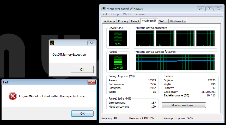

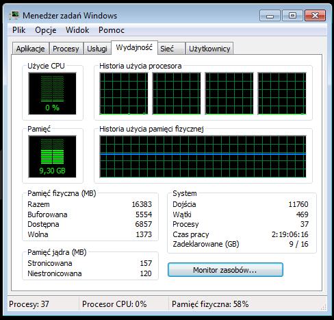

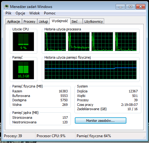

Virual memory = 16MB only.
Physical memory = 16GB
SFS=220 (first screen shot)
SFS=220 (second, after closing OUT OF MEMORY screen)
SFS=150 (third screen)
Jarek
