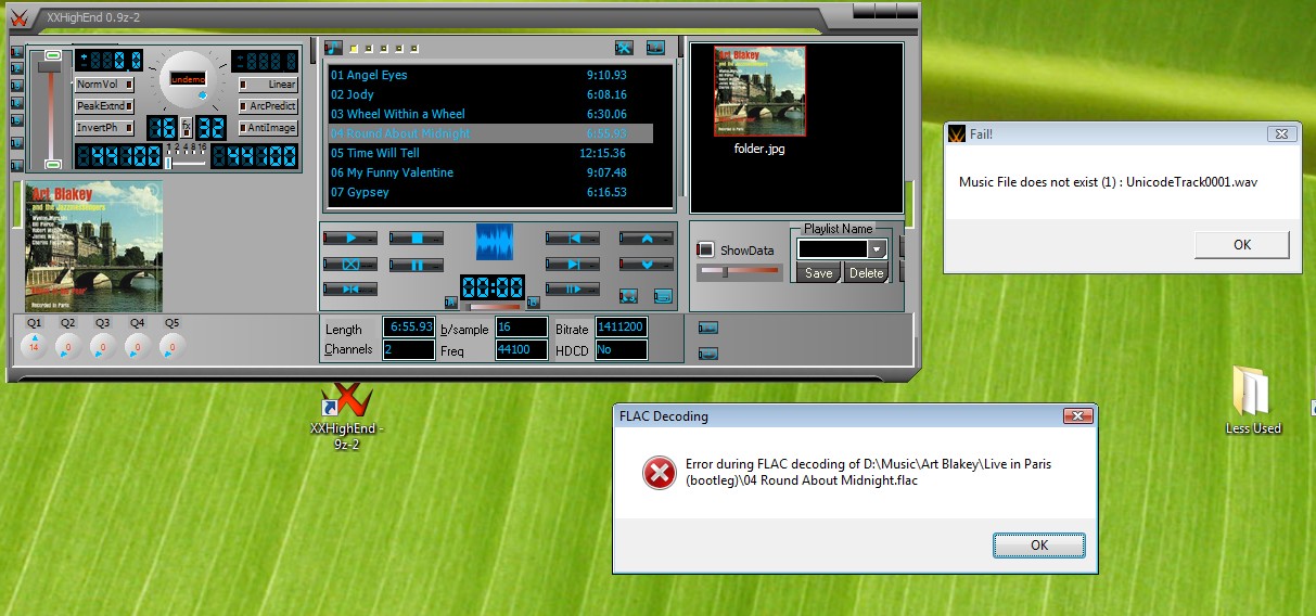

here is the errors I get when I try to play file

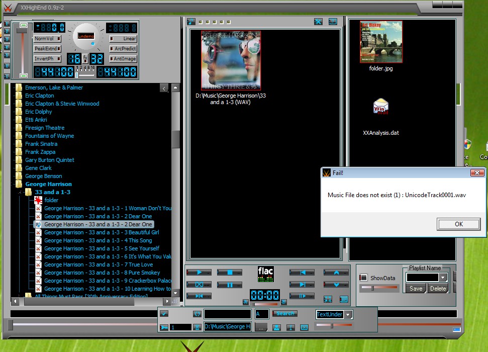

here's the other error I get
« Reply #17 on: November 20, 2010, 06:59:04 pm »
This should be real ... (never mind Foobar etc. plays it). Can you try another album ? Preferrably one you ripped yourself or FLACed yourself (a bootleg doesn't look like that much Happy).
Or try a .WAV.
We'll get there !

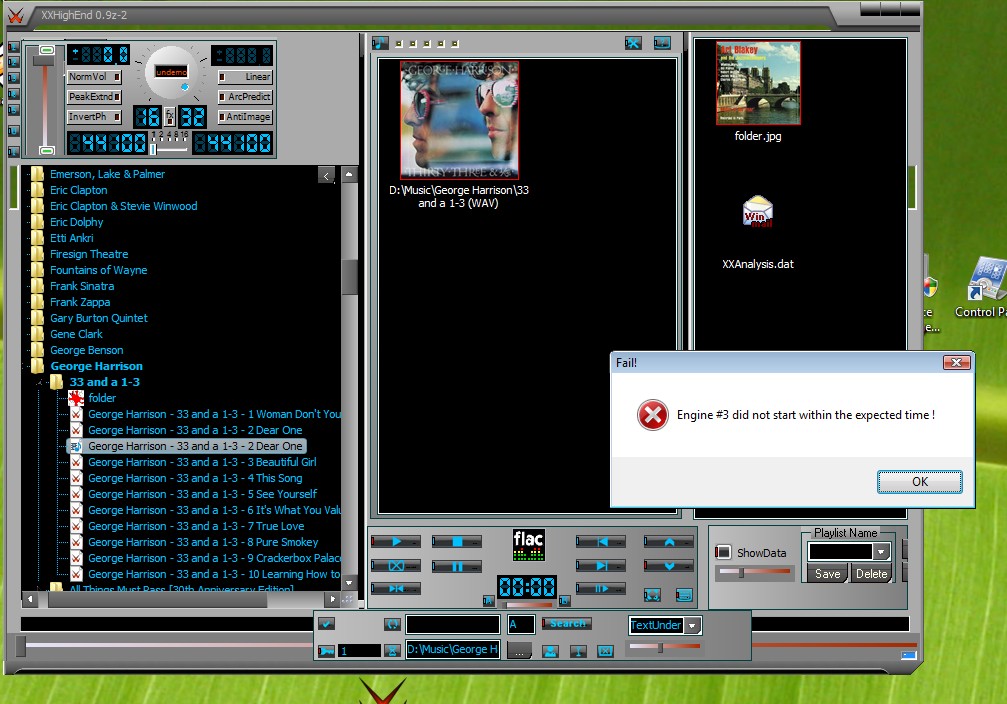

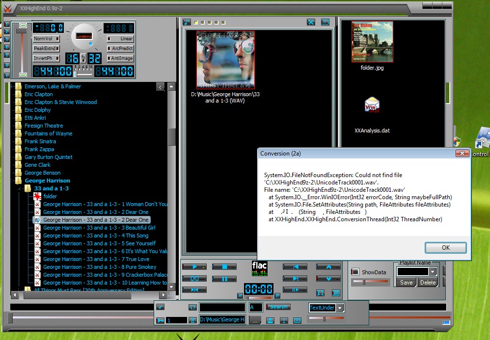

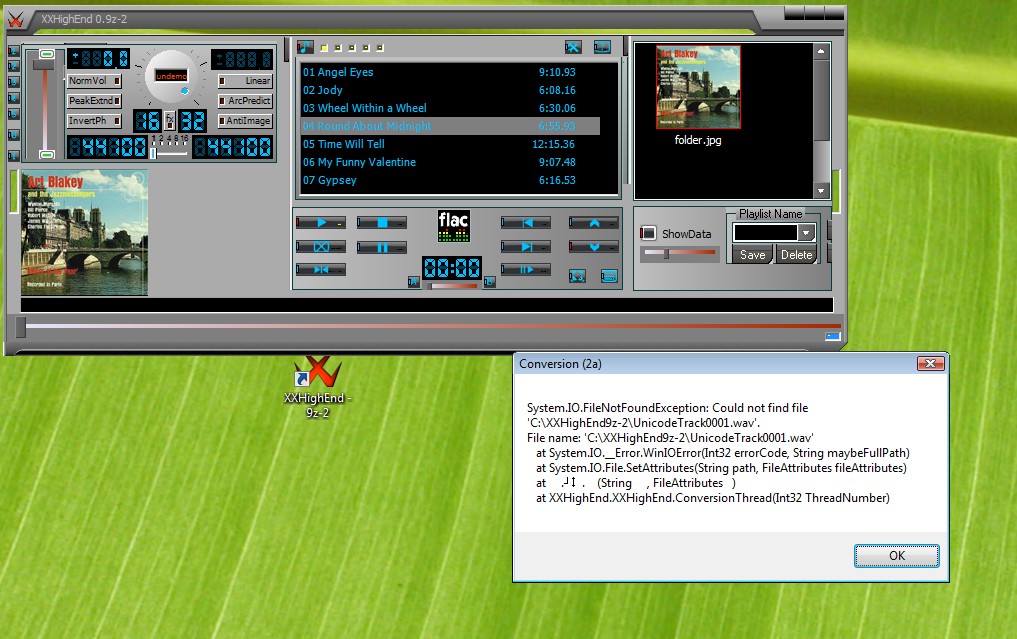

« Reply #18 on: November 20, 2010, 07:32:44 pm »
Sorry, I chose that flac file at random. But it does the same thing with every flac file.
Also just created wav file and tried it, will include screenshots of error messages.

« Reply #19 on: November 20, 2010, 07:37:07 pm »
This was with Engine 3. I also get same errors when I switch to KS and engine 4.
« Reply #20 on: November 20, 2010, 07:44:47 pm »
Well, you are a record holder now ... two of these things from one person on one day ... haha
You could try whether "Copy to XX Drive" (Settings) Yes or No makes a difference, especially for the .WAV file. But again I really don't get this (and this really doesn't happen often !). The only thing I see is that your music is on the same drive as XX is. I currently wouldn't know how or what, but can you copy an album to drive C: (or anything) and then try to play it ? Notice : to be sure in situations like this that you're not using old files or locations, please use that button with the cross (X) on it left under the Search button from your last screenshot - before pressing Play.
After the above, best would be to try a .WAV and NOT Copy to XXDrive. If that gives the same messages I'm going to eat something like a tie or so.
And have a beer.
Sorry for your troubles ...
PS: Yes, the sound engine won't matter here.
Btw, whether it starts to work or not, the XX log file would be convenient for a not working case.
« Reply #21 on: November 20, 2010, 07:46:49 pm »
A disk full would be a normal reason for these errors ... nea
