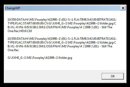

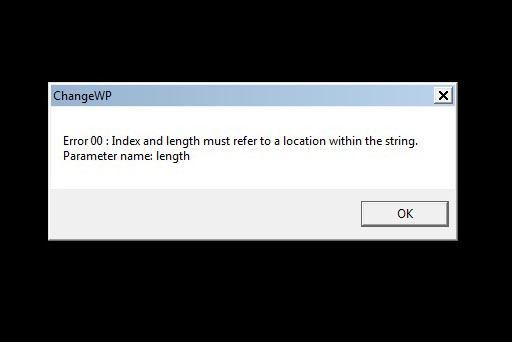

I queued up a Fourplay album a short time ago, simply called "X", and when the GUI disappeared and the wallpaper was expected, the following 2 messages came up. Thinking the error may have been due to the short album name I then tried again with one of their other albums called "4", and the same error condition resulted. I then tried yet another album, this time with a longer file name and residing in the same artist folder, and all was fine. The folder art appeared to be intact in the actual gallery folder for the 2 albums in question.
In both the "X" and "4" albums, the same 2 part error message occurred before each subsequent track.
Hopefully you can replicate the condition.
I can't recall reading about this issue before.
Edit: Similar events occur for Stanley Clarke & George Duke's album named "3"

I must honestly say that I have run into 3 or 4 of these messages (situations) myself lately, but couldn't see the line in them. I don't recall the albums to have short names like this, but I certainly will look into that. Should be easy to solve.

« Reply #4 on: April 10, 2011, 08:21:08 am »
Yaahhh, but wait. Your album isn't named "4", it is is named "4 ( 1998 )" ...

ah .. umm .. oops ! blush1
I name all my albums with the recording date at the end and never gave it a second thought. I'm sure with this new piece of "evidence" you can figure it out now:)

Solved in 0.9z-5. heat
