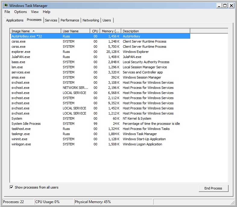

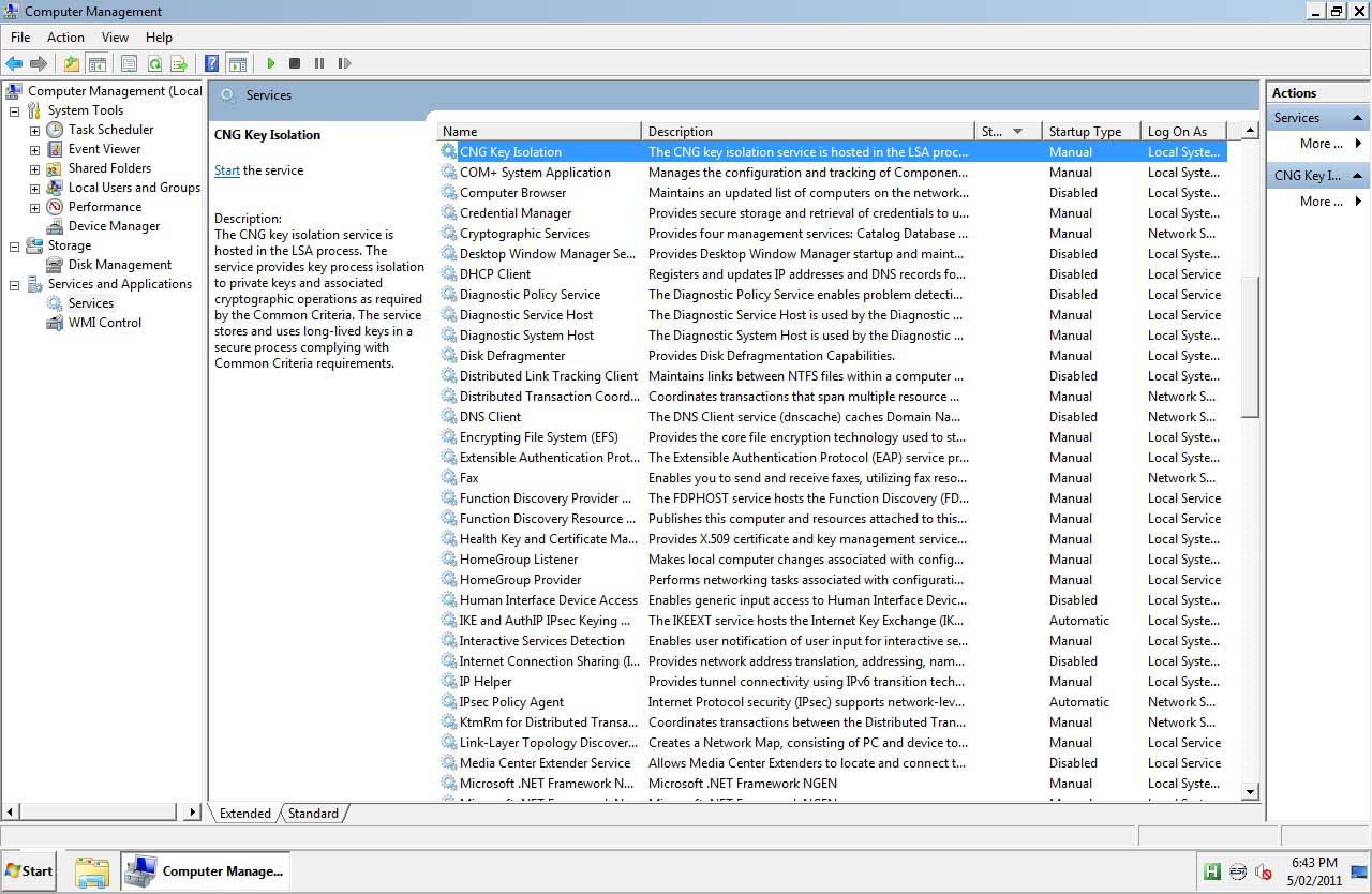

The following screen captures may be of assistance for those wishing to cull some of the non-essential services that normally run following a typical install. I am running Win7 X64 SP1, and my decisions as to which service(s) to cull came mainly from the info found in Black Viper's website.

Note that my music server is dedicated purely to playback using XXHE only, and as such has NO LAN connectivity whatsoever. Any data transferred onto or from it is done via a Zalman ZM-HDR1 drive bay, or memory stick for smaller files. No virus protection is loaded or needed.
I also disabled a lot of logging activities as discussed in the "How I tweaked my Vista virtually dead" thread, and other tips from within that thread.
Upon startup, there are a few services that normally run for a few minutes to 10 minutes then close, and the screen captures below reflect the system after things have setled down.
If you are in doubt as to the safety of stopping any service, in addition to Black Viper's valuable explanations via the links on the actual process name in his tables, simple google the name and you should get a good idea as to it's function.
There's still debate over the influence of running processes and how they may or may not influence sound quality, but I figure if they ain't running it does no harm and at minimum, frees up resources.

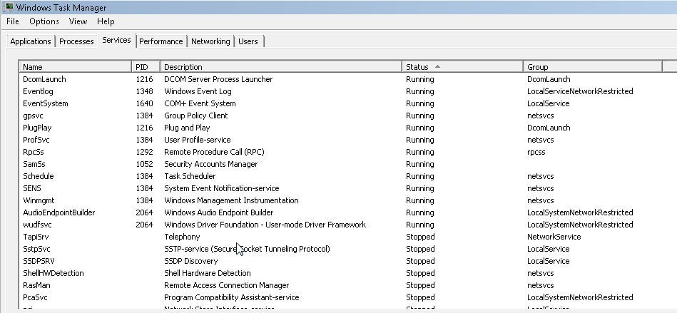

Well, something like the below I guess ...
Maybe one service less than yours, but who cares. And this is Vista (32) by accident.
Anyway ... great job for pulling out this nice list ... which will be in 0.9z-4-1. Actually, it already is (again, see below Happy).
Btw, at the bottom you see a small picture telling that even Audio isn't running anymore. I'm not sure whether this is intentional or unexpected, BUT, the audio for Engine#4 still works ! Not for Engine#3.
At this moment I don't care at all, so please do NOT bother to sort this out (and again, this is Vista).
Actually strange. This will be Audiosrv, and I now see it's not in my list of running services. So I guess it must have come along (the stopping of it) with something else ?
Again, no big deal, and I will be able to find how or what, but that audio is actually playing ? ... (KS)
« Reply #3 on: February 07, 2011, 09:19:13 am »
I can confirm that AudioSrv and AudioEndpointBuilder services are not needed if you use Kernel Streaming. In fact, with those two services disabled, the option to use Engine#3 is removed from the drop down list in the parameters page. If you use your PC for other, non XXHE purposes, leave those 2 services intact.
