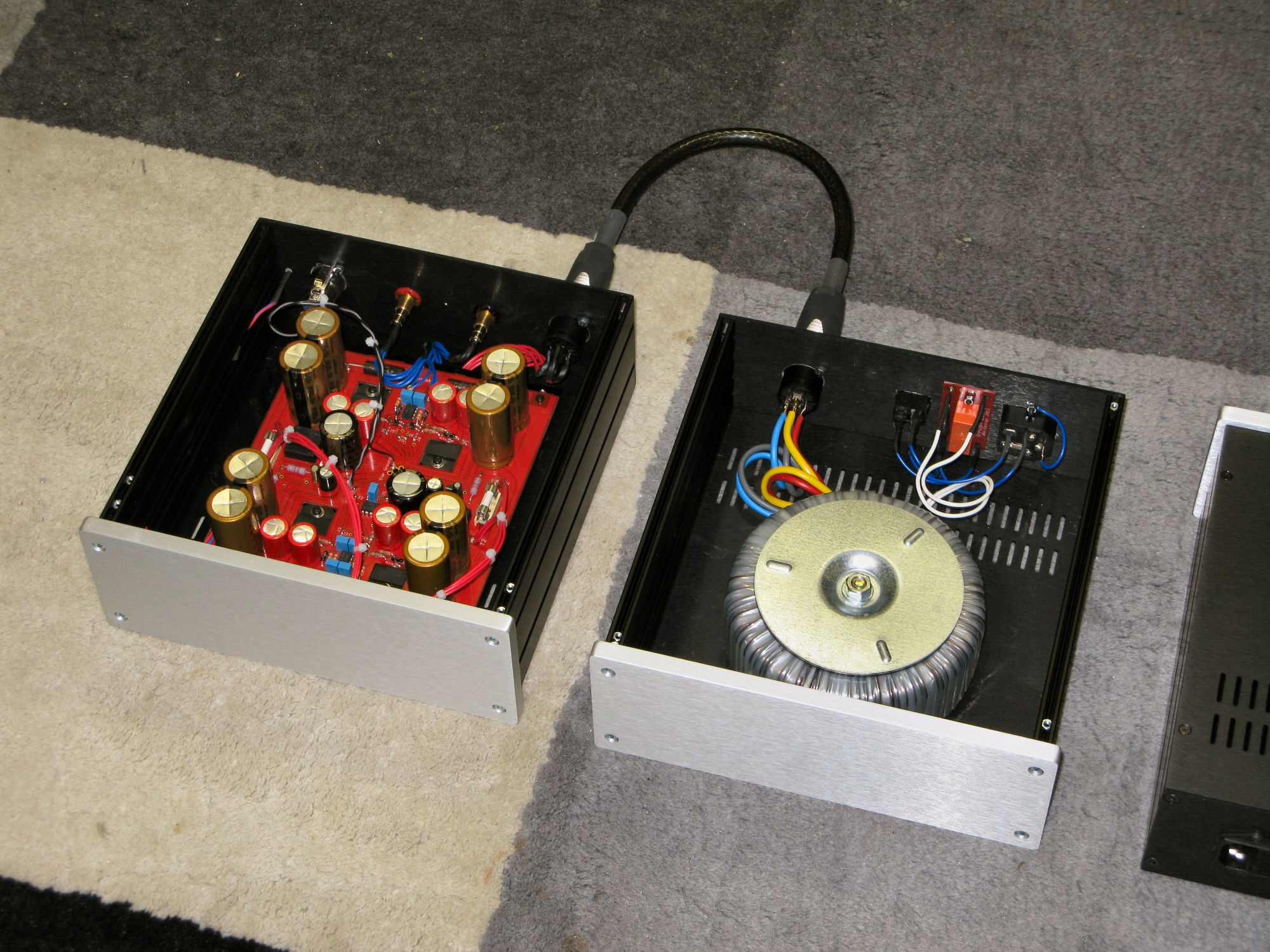

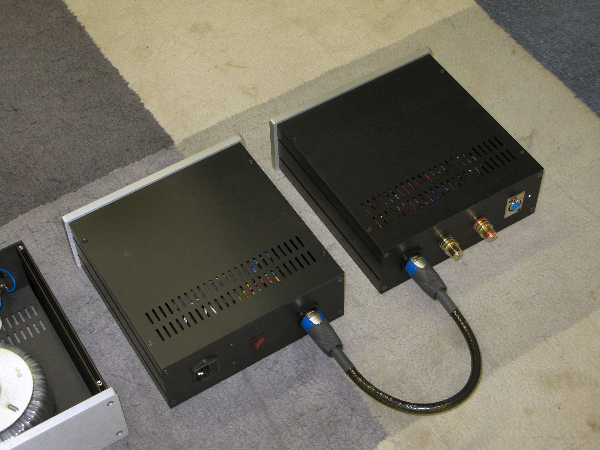

Hey guys, listen up now. My 'super' gainclones will arrive here today!
Bert (BD-Design) built them for me, and from the pictures (posted with Bert's consent) you'll see he seems to have done a really great job. And Paul (Scroobius) yes, they really are Black Gate Ns - 8 per channel!!!
I just can't wait - actually, the last time I was this excited about hifi was just before my original NOS1 was due to arrive, around this time last year IIRC.
This post may be a little premature as I haven't even tried them (not here yet), but I wanted to give you all a heads up.
I wonder if I'm the first person to have tried driving electrostatics with gainclones?
« Reply #148 on: December 20, 2011, 11:24:02 am »
Hey Mani - they look familiar  Happy excellent taste in enclosures I must say.  Any chance of a picture where we can see all three boxes with the tops off looking from the rear? On the other hand I suppose that the other box will be another amp identical to the amp we can see in the picture?.
Only one transformer ??? or does it have two secondary's one for each amp?
If the amp does not work out with the Quads you could always give those Blackgate N's to a good home (i.e. me) - I promise I would look after them for you he he  Happy.
Just out of interest what size (uF's) are the BG's?
P
« Reply #149 on: December 20, 2011, 11:41:43 am »
+1 on the enclosures  Happy
Mani,
They look fantastic, a great build by Bert and I bet the post cannot come fast enough   Happy
Not just 8 Blackgates but 8 BG N types, that should really help the sound.
I think I can count 4 amps per channel, are we looking at bridged parallel for each channel with differential inputs ?
Very, very nice I understand why you want to hear them.
Best Nick.
