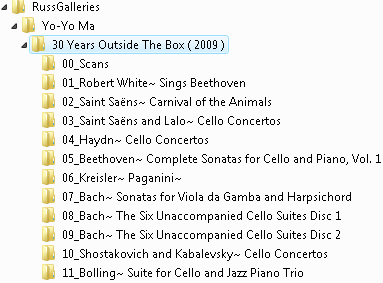

« Reply #35 on: June 04, 2011, 10:14:57 am »
From the hell of chaostry :
Look below. Somehow you expect me (XX) to recognize that the 00_Scans folder is seen as a folder belonging to the BOX set. How can you ever see this YOURSELF ? now, let's agree from now on that when you can't see it yourself, I can't make anything for it.
And no, the "00_" will do nothing. Happy Nor does the word "Scans".
Next ... How would you see that these individual albums are part of a Box ? Because the higherup folder is called "Box" maybe ? Nope. I don't see any provision (nor attempt) to make this a multi volume album.
All what happens here is that this is a "structure", in 01_ u/i 90_ (shown up to 11_ here) music data is found, some coverart in there as well, but that nothing will lead to looking higherup again for general coverart (reciding in 00_Scans).
Also try to see the actual similarity with the Yo-Yo Ma level, which for the same matter also could contain Coverart. Well, ehh, haha, why not. So, if *THAT* would be the rule (infinitely look upwards for folders containing Coverart), then it would work again. But let's say that, though a nice idea, it would be undoable for me. Think of creating a Gallery, that very main Coverart not being there at first, and a with a next album for that same structure, it is. But now the other way around ... Deleting albums from Galleries. This already is as complicated as it is, because that too needs a sort of keeping track of "can this empty folder go now ?". Working like this would mean explicitly throwing out "elementary data" (I can't see it is related), which in the end always *will* lead to throwing it out when I think it's okay, never mind it never was data not related to music at all. So, too dangerous (it already is, thinking about "Scans" folders at the same level of music folders, especially when it is MultiVolume ... that leading to a similarly dangerous situation, but that happening at a "related level" (one up).
wacko
This is also a nice example for me for indicating the response implications;
What do you want me to do here ? examining all the music folders (which I can't know) on music being in there, that first being the case for all of them to next find exactly one for which this is not the case (Coverart only) to denote that one as "Coverart" ? See ? this is why things are overly slow at this moment, because exactly that is happening. Yea, well, was - because I reverted to the old means.
For this example anyway it wouldn't help, because this can not be detected as MultiVolume.

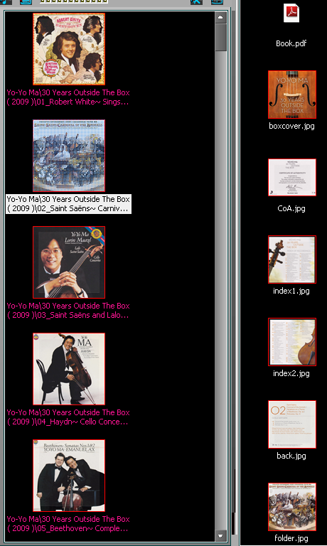

Btw, still you can see that things are doable for sorting out by looking at the second picture below. Here you see that only the last two Coverart files are album specific and the others come from Coverart files being in the "30 Years Outside The Box" folder, which is where I put them manually (coming from the 00_Scans folder). This is a static situation though, looking from one album (the 02_ one) which really is different from having to create the structure - nothing being there at first (keep in mind : the folders with music data trigger here, NOT any coverart folder, because then soon I'd be copying your Program Files folder ...
Well Russ, didn't I say it ?
There's also people who really think that all will work automatically at putting all the coverart of all the albums into one folder, change the tracks from the albums into cue files so all become "one track albums", to next think that all those one tracks can be in one folder all the same ... to next tell me it doesn't work.
Of course I didn't expect you to be the example, but here you just have it. This time because there is no provision for knowing it is MultiVolume, but I think you can see the problem now clearly. "Chaos".
Still I will think about it;
I want to let this work automatically, but if rules as such are needed to it, it won't work afterall. Must get smarter ...

« Reply #36 on: June 06, 2011, 08:47:56 am »
(added the emphasis)
"Chaos" between quotes of course, and I was only continueing on my expectation of how some expect things to work while they "obiously" (swoon) never can. But before Russ is equalized with such a suggestion, let me better and explicitly make clear that nothing of the sort is the matter here. Well, except for that *I* (XX) didn't provide a good means to let this work properly. Russ only provided the best structured means thinkable and it still didn't work. Of course the example in particular (Yo-Yo Ma) is quite challenging, although many more exist days days ("the complete work of" etc.). The "Box Set" on this matter is special, because it's actually a collection of, say, normal albums, now in a container and really being different from the individual albums (might they exist - but this assumed).
With the notice that a Box Set can be setup like normal albums - each album "flat" under the others, but the name maybe always containing "Box Set ~ 30 Years outside the Box (2009) ~ [here the individual title]" let's see what Russ made of this :
Referring to the pictures in my last post, you see that the whole Box Set is contained in one main folder named "30 Years Outside The Box";
Within that folder (thus holding the (Multi Volume !) Album as such) he preceeded each individual Volume with a sequence number. This number is equalling the physical Volume Sequence Number. Also see the Back.jpg at the right side in the picture which denotes "02" while I had the second Volume selected in the middle pane.
Nothing is more logical now to make a folder named "00_Scans", the 00 part of that causing it to be the first in the list, which already will be convenient for yourself if you want to browse through the Coverart by means of normal Explorer. Or add new in there. Notice that in this case the first 5 pictures from the right pane are in there, and that the right pane will show all Coverart found for the particular Volume. This includes the Coverart which is dedicated to the Volume itself (02 in this case) but also the Coverart which belongs to the whole Set (like the Book.pdf, the front cover of the box, the back of it, and the index pages to the Volumes). The "trick" here is that we'd want to see all the Coverart always, while we don't want to store the Coverart belonging to the whole Box redundantly.
Notice that while the General Coverart is stored in the 00_Scans folder, it also could have been stored in the "30 Years Outside The Box" folder (at the same level of the Volume folders). Both work equally, but both can not be used mixed !! Thus, XX can not use two "general coverart" sources - only one - but either of the means will work. Also keep in mind that this is similar to having to "Scans" folders; only one will be used, and probably it will be the first in the (alphabetical) list.
It is important to know that the just said "will be used", is not only about obtaining it and show it, but is also about creating Galleries. This means that only one source will be copied, and the other is just not seen. For example, if both a "Scans" folder and individual files at the higher level (as decribed) are used, the individual files are not copied.
In the end this topic is about how things are copied and changed by the program (have the latter above as one example), and not so much at all about how *you* set it up. Thus, despite my ever attempts to explain how to setup a nice structure, actually it is not about that, and merely how XXHighEnd must deal with it in order to let you work with maybe any structure (but keep in mind the logic !).
