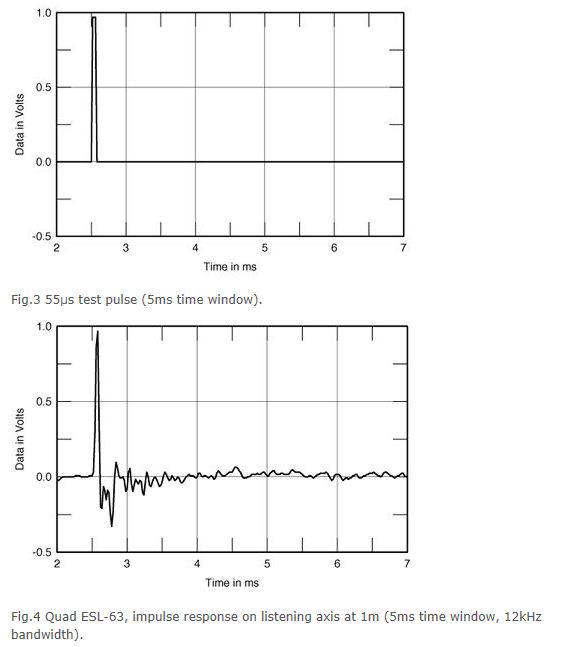

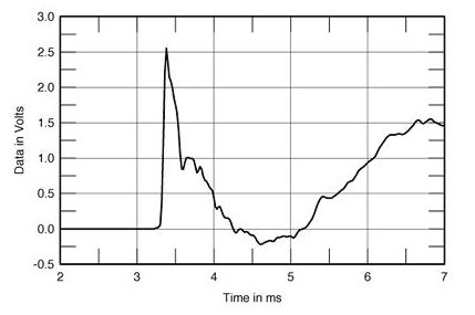

Juan, I think this is where the genius of Peter (Walker, not St) comes in. He found a way to convert a 'large' panel speaker into a point source. Their sound, especially from the lower mids upwards, is absolutely pin sharp.
« Reply #37 on: August 23, 2011, 07:58:50 pm »
Ah but none of these can produce a 1KHz square wave like an electrostatic can.
Of course, this was said slightly tongue-in-cheek. However, there is a serious connotation.
PeterSt spends years on perfecting his DAC. He gets it to a point where it can pass through the signal totally unadulterated. Square waves are not converted to sine waves by the massive sigma-delta filtering of most other DACs. The output stage is massively fast. The recommendation is then to use ultra-fast amplifiers to preserve the signal. And then what do we do? We feed this amplified signal to speakers that haven't got a chance of replicating the signal exactly...
In fact, I'm convinced this is why sigma-delta DACs actually sound 'OK' to most people on the majority of systems. They are just doing to the signal what the speakers will do anyway - turn squares into sines. And what does this do to the sound?  Well, just listen to a sigma-delta DAC... Happy
Furthermore, I'm convinced that the 'time domain' is far more important in audio than the 'frequency domain'. Is there another speaker that can match electrostatics here (see attachments)?
But look I agree with you all. If you have a pair of speakers that you like the sound of, then that's great.

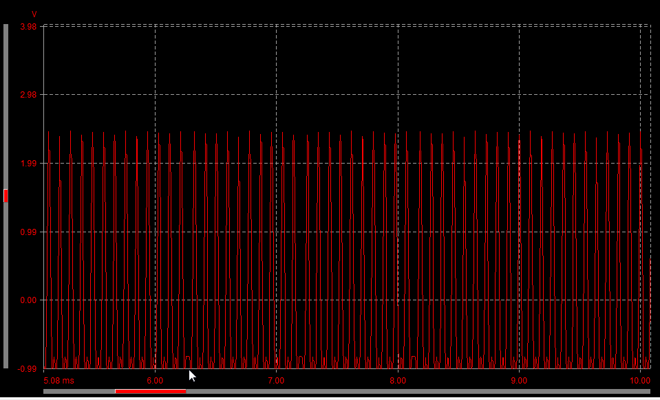

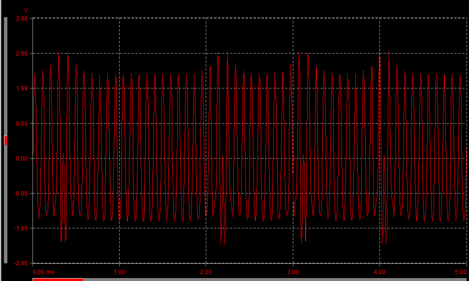

My view (if not known by long) :
First of all, measurement tells all. Yes, I know look like a stupid engineer without thinking, but mind you, ever back I was not like this. I'm not sure I was from the leage "a nice tube sound will improve the sound", and all I know is that I ever hunted for "being able to measure". Even the stuff which can't be measured, I made measureable. Not only for sports, but merely because it would be non-sense not being able to measure what we hear/perceive.
Next thing, is that I *know* that when things measure better, sound will improve. It *will*. But this is a most dangerous thing.  I mean, if I measure one device and that measures better than yesterday (because of some tweak, whatever) it is not said at all that the whole system now performs better. Read back on Mani's post with the little graphs. That really tells it all. Thus, improve on the impulse response on one side, and tear up your speakers diaphragms on the other (so to speak). That did NOT turn out for being the better (solution).
For this reason the real moral is to have the reference. And here again Mani hits the hammer on the nail, because he knows that at least the NOS1 is such a reference device. I know that too, and only if one doesn't trust that things will become more difficult.
By now I know that my amps (the GainClones) are a reference just the same. This is 200% important, because now all what's left is the speakers (ok, assuming the software does a nice job as well, and which I *do* assume these days).
While there's now only one part left in the chain, it is theoretically the most easy to improve the chain, because it's only about the speakers. Not that I'm working on that though ...
I can't emphasize enough that everone who is using a preamp or even single resistor to attenuate the volume CAN NOT know what he is talking about. He may think he knows, but all he does is implying measurement results which WILL look totally wrong. What's the bet ? 1000 ? 10000 ? I am ready for it.
Besides that you will loose the bet, you will be the most sad that you thought you were listening to a fine system, while actually you were listening to a bunch of filters, them masking all the other stuff being wrong. The test is so easy : take out your preamp and notice that the sound gets worse. In that case, it *is* worse, and something *is* wrong.
But then, don't even attempt with an OS DAC. You really won't know what you will be listening to.
Ok, I will attach two graphs, because I made the graphs anyway. No real text. Not yet.
Both graphs are from the same playback file. Same scales (and both cover 5ms of music data, though they don't start both at the 0ms point which does not matter).
Look at the mouse pointer in the second graph which is key to the distortion in the first. Notice that there are two more of these sneaky points (the first graph shows 4 of them in total).
I don't need to ask you which is which, and hopefully I also don't need to ask you which one you'd prefer for listening. But I can guarantee you (by 100%) that any DAC not being the NOS1 will let you listen to the graph NOT of your choice. That bet too is on.
While this is the analogue output from the DAC, I just could have taken it from the LS outputs from the amps. It most probably will look the same, although I never tried it. Point is, when the slew rate of the amp is too low, very nasty things will happen, up to a an almost flat line. Well, looking at the graph you do NOT prefer, that might just as well work out for the better, right ?
Now, let loose your imagination on this.
I have prepared dozens more of these graphs. For later ...
