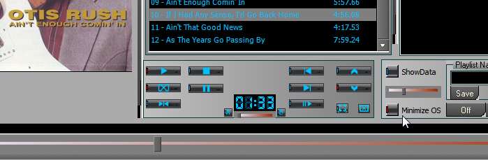

This button is under the right pane and is called "Minimize OS" (shown in the active state below).

  • The text to the right of the "OS Minimize" button (meaning that text itself) can be rightclicked upon. This changes the current state of the button, might things have run inconsistent. Normally it is not needed to change the state of the button, so this is an emergency procedure.
    In any event notice that using the button will perform the action implied by its state. Thus, when it is active (red), normal left-click will imply a reset to Normal State, no matter the state the OS is in. And the other way around.
