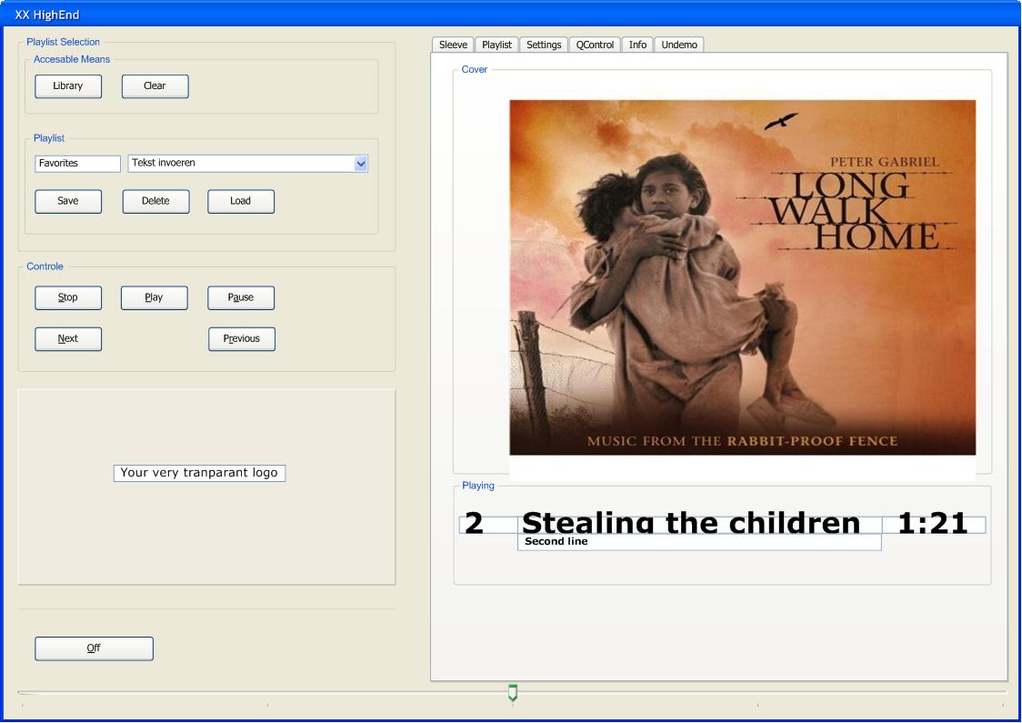

« Reply #9 on: September 14, 2007, 09:20:58 pm »
When I was listening to Erik Trufazz I got very loud cracks, .............When I switched the Inverted fase off, the cracks where gone. I have tested 0.9i-1 with the same result.
Still in 0.9k the Loud cracks!!!!
Other suggestions:
  • Memorizing the selected output;
  • Remote controle of XXHighEnd;
  • Layout suggestion, see attachment.
Regards, Johan
