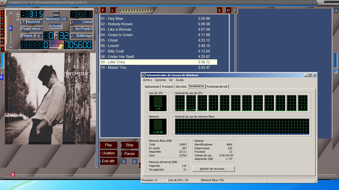

« Reply #5 on: August 19, 2012, 05:37:48 pm »
As I said I have stops and pops when I use the settings that can be seen in the previous post. I can avoid the glitches if I set the SFS to 50, the sound is also great but it seems more accurate with SFS at 2.0
Following the advises of A Guide to Glitcless Playback
(http://www.phasure.com/index.php?topic=2029.0), I´ve started the Task Manager to watch the cpu and memory behaviour, I haven´t seen notorious spikes at different settings as you can see in some printed screens.
At the end in the Guide it is said: "If you hear problems but don't see it on the cpu graph, watch the disk light and see whether it's related."
I don´t understand what disk light is talking about.

« Reply #6 on: August 19, 2012, 06:01:04 pm »
Hey Juan,
If it were for me you are mixing up things now. I mean, first you say that with Playback Drive you have no issues, only at start/stop, and next you continue with "but without Playback drive I have glitches". This does not work for me, because now I don't know what to answer anymore. So, one thing at the time, and I don't think it should be about anything with the Playback Drive in use (and otherwise rebuild your PC because it is clear (to me) that something is not right or on par). So …
With "net" buffer I mean the result of the product of Device Buffer Size, Q1 and Q1Factor. Otherwise see the ToolTip on Q1Factor (I think it is described there). Remember, this is about Start/Stop only, like you brought it up yourself (as actually the only issue).

When you hear glitches (or plops with Phase Alignment engaged) ... a disk light is a light which flashes when disk access is happening. Since all is priority related (OS and hardly XXHE), when sound stalls (a plop in your case) during disk access, you can bet that something chokes in that area.
