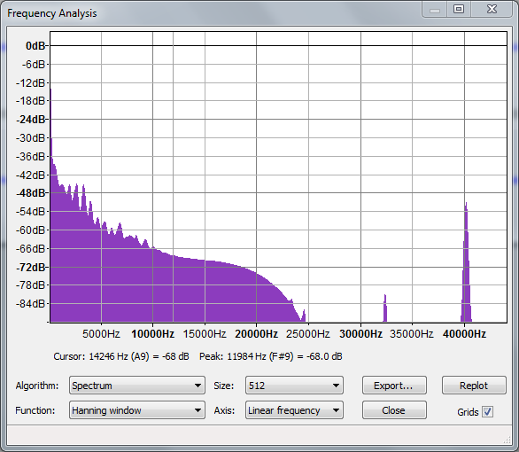

I am building amplifiers from ten years now , and somehow I do know a bit of them . But also your dacs may be at risk .
So , being it a crack or not it is to be understood that is not only DC . That fenomenal generates a spread of frequencies up to 40KHZ , which can also be bad karma for your Tweeters .
Below find the picture of the spectrum plot referred to the previous (simulation Peter ? ) example posted by me .
The analysis of the spectrum is made just when the thing happens , during the drifting .
Stefano
Stefano

« Reply #34 on: September 08, 2012, 12:57:01 pm »
Hey Stefano,
[this responds to the picture with the FFT graph; not to your last post]
Yesterday I wrote you a post which became more and more complicated and I decided not to post it.
Today, with your new graph, I must really try to let you refrain from judging (and posting) based up wrong "data". So, I already told that your graph exactly shows what Carsten will have on his hands, and this is "wrong" hence not intended. So, now we can try to proceed on what's wrong in the base anyway, but to me this seems useless *and* confusing.
That it happens like that is another story and it is to find out why. But "explaining" like you do what happens with Phase Alignment ... please don't.
Btw, that 40KHz will be about the end-front connecting of the buffer and the steeper transient occurring because of it. And otherwise it is about the upsampling or whatever (like DSD origine).
So, don't please.

« Reply #35 on: September 08, 2012, 01:00:39 pm »
Hey Stefano,
So, don't please.
