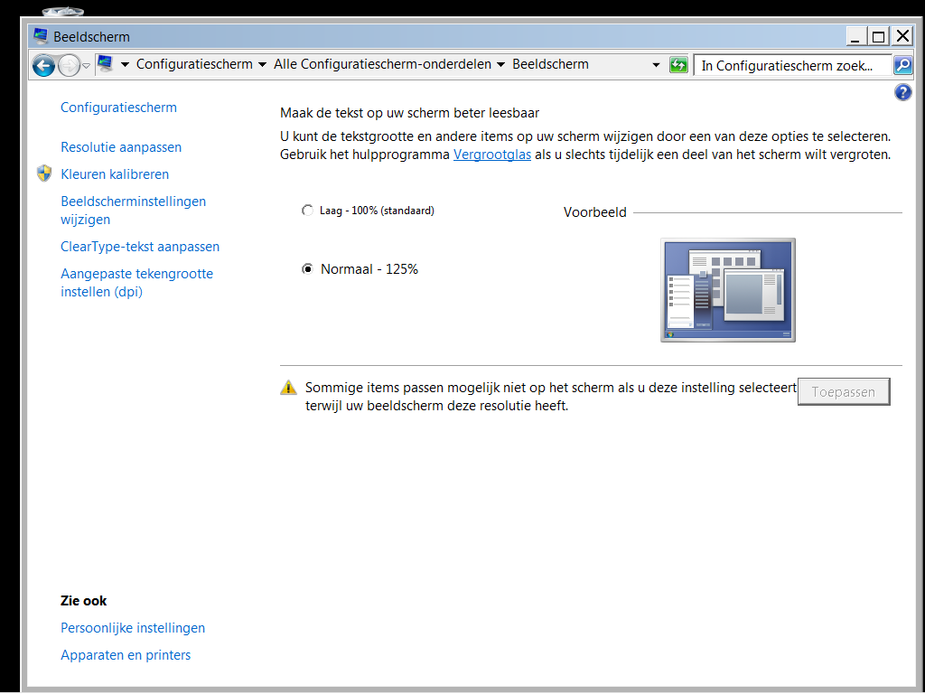

« Reply #26 on: September 24, 2012, 04:23:01 pm »
 OffTopic
If you mean about that blue button.
This is what i have. When i change it to 100% that blue button is not there either.

« Reply #29 on: September 24, 2012, 05:45:30 pm »
Well, the important part is :
You set your OS scaling to 125% which is not compatible with XXHighEnd's scaling. This is why you have the anomalies (like that vertical bar right trhough everything). This is why I told (in that other topic - where I would like to move these posts to if I knew where to be) that you should set the OS to 100% and XXHighEnd to 125% (1.25) if you want that size. Then all works fine. But additionally, right after using the Scale functionality (or apply a Preset for that matter) the screen is not correct (like the MinOS button lacking). So, quit XX and restart it to get that right again.
Besides, when you use the Scaling of XXHighEnd a bit larger than 100% (1.00) those lacking "numbers" will be there (like in the Preset buttons in the left).
Now, if you can find that other topic for me ...
