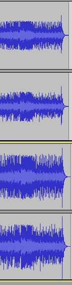

Thanks Coen. Anyone else want to have a shot?
 a)I hope the bottom one to be the LP
 b)Midlle one the rip
 c)Upper one the conversion asf. At least the left(upper) channel is compressed and somehow limited.
Ed
« Reply #16 on: January 28, 2013, 12:28:19 am »
a: cd     peaks cut off
b: lp      highest irregular peaks
c: sacd  in between a and b
What do I win? Wink
« Reply #17 on: January 28, 2013, 06:50:41 am »
B = LP
The others would be a guess.
« Reply #18 on: January 28, 2013, 09:42:00 am »
1 = SACD
2 = LP
3 = CD
I said it before : This means of DR measure isn't worth much (I can easily tweak it for the clear worse, while the DR number goes sky high).
So ...
3 is the good master version of a CD.
1 is taken from the bad master version of a CD which also exists.
2 is quite noisy and thus your LP. And no, I don't derive the noisy from the obvious. Happy
The DR from 2 (LP) looks right to me (despite what I said above) and this is because no precautions were taken to compress it somewhat like has been done in 3 and more in 1 (this is not necessary for LP).
Warning :
1 (my SACD) and 3 (my CD) can just as well be turned around when the masters used are turned around. Then this would come from it :
1 = CD
2 = LP
3 = SACD
with the explanation that the only thing happened to 3 is that it was expanded from the same master as used for 1.
And if that were not all, the "master itself" as we could see it in 3 can already be an expanded one of the master used for 1.
What am I saying ?
That both 1 and 3 can be CD which I can easily show you. Ok, I will, see below.
So the question : which one is the SACD ?
haha
Moral : it tells nothing because it depends on the master.

« Reply #19 on: January 28, 2013, 11:22:05 am »
The 'winners' are... GerardA, Christoffe and of course Peter!
The order was:
File 1 = CD
File 2 = LP
File 3 = SACD
What's interesting for me is that these were all derived from the original 1990 digital master, which from the spectra (not shown) is quite clearly 44.1 (and almost definitely 16 bits). Why the massive compression on the CD? I have no idea. There seems to be a little bit of compression on the SACD, whereas the LP doesn't seem to have as much (or any).
FWIW, I prefer the sound of the vinyl. I know it's from the same digital master as the CD/SACD, but to me it's simply more satisfying to listen to. Is this due to the lesser compression? Or perhaps a euphonic effect caused by the inherent distortion in all LP replay? I don't know. But what I do know is that even XX and the NOS1 can't 'polish the turd' they've put on the CD.
As so many people have been saying, we're stuck with what the mastering engineer did and no format is going to be able to improve on that.
Mani

« Reply #21 on: January 28, 2013, 12:24:46 pm »
No no no, I can't be a winner because I supplied two solutions. But to be clear, the screenshot of the two files I provided were both from existing CDs. Both exactly resemble the 1 and 3 provided by you, Mani.
To work it out further you could look into the SACD hi-res rip you will also have. Does it contain frequency above 22.05KHz ? I'm afraid it will not. And when not, both are from the same digital source which shouldn't be "hires" in the first place. The SACD is just expanded somewhat and is the same as my second picture (which btw is an MFSL).
Not that it is all *that* important, but this is how our own rips from vinyl can work out for the better. Not that I will believe that more than 20KHz can be obtained for it, but for the remainder ... yes.
Thank you Mani. These things are always fun.

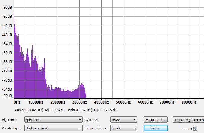

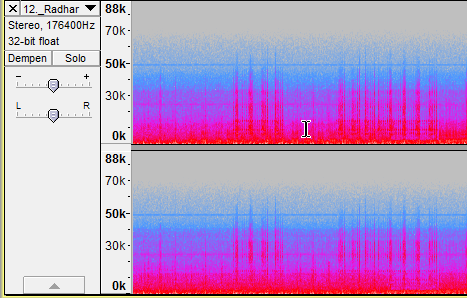

« Reply #22 on: January 28, 2013, 12:36:50 pm »
Nope, no signal over 15KHz or so. It does make you question the wisdom of putting a 16/44.1 master onto SACD - but I guess your equipment appreciates the HF workout.
EDIT: for completeness, I've added the vinyl 24/176.4 recording spectrum.

« Reply #24 on: January 28, 2013, 01:24:05 pm »
Mani, no. I know that "analysing" this sh*t is difficult, but your LP goes to 15KHz just the same. The remainder is sheer noise. Sorry about that, but this is how I see it.
Set the scaling to liniar and use any windowing you like, but no "hires" behaves like this.
The top of the caret is where the music ends. The remainder is "anomaly".
Besides that, I don't think it can exist from LP, although I don't know the price of your cartridge. But still ...
« Reply #25 on: January 28, 2013, 01:31:46 pm »
But the graph of the LP ? Can someone explain why there is no dip ?
Alain,
With some imagination you can see the dip just the same in my screenshot from my previous post. But this is coincidence. Well, unless the LP was taken from the LP of course. Hahaha, and you know what, this can even be true (DSD recording - ehm assumed that this existed in 1990). But too far sought anyway.
The dip in the SACD is from "noise shaping". Think like "the 1-bit quantization noise is moved to beyond the audio band".
In this case Mani will have done that himself. So, he determined how steep the "audio band" ends and where the (inaudible (??)) noise starts. Mani may have used Audio Gate for that which IMO is no good anyway. But alas. Mani will tell it himself if it suits him.

« Reply #26 on: January 28, 2013, 01:41:48 pm »
Hey Peter, I agree 100%. What do you think I meant by "no signal over 15KHz"? I was talking about the original master, and therefore all of the versions too.
EDIT: On the graph that Peter showed, it's clear that there is output from the cartridge all the way to 30KHz, but no signal on the LP. So it's just noise from 15KHz to 30KHz at about -84dB.
Oh and the cartridge cost me about the same as a NOS1!

« Reply #28 on: January 28, 2013, 01:52:04 pm »
Yep, that's what it is.
I just told Audiogate not to apply any filtering, and that's all. The dip from 15KHz to 22KHz on the SACD is identical to the dip on the CD. However, after 22KHz, the noise builds on the SACD due to the noise-shaping.
What's interesting for me is that these were all derived from the original 1990 digital master.
Maybe. But then not the best.
Yep, certainly not the best. But it's the reason I chose this track... to show that the mastering is the most important factor, before format.
