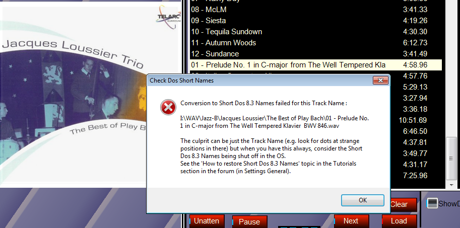

I don't know whether this is going to be the most puzzling issue ever, but it well could be;
For starters, this dedicated to NOS1 users. Just to make that clear.
It will be related to these long file names, but there is no normal clue as to how.
The sampling rate status of the USB Interface is obtained, and the first what happens it that it is presented not equal to what is wanted. This already seems wrong to me, assuming that Paul not just (and always) has played something with another (output !) sampling rate. IOW, the USB Device does not respond how it should.
Next, because the sampling rate is presented to be not as should, it is set. This is attempted for 1.5 seconds in a loop of 15 times. This fails (too).
And then the message is presented.
It is noteworthy that I saw this often under W8 with the special environmental thing that I in there I had the WiFi-special driver running.
If I combine the two situations, both can be about something else preventing the USB Device to respond.
Since for Paul this is about the long names, it is important so see how they may work out in wrong fashion. And ...
... After typing this I already see it. It does not work at all.
Here's one from my own log file :
Short Name initiated-1 : I:\PS\(CLASS~1\(13)RE~1\Bach\BACH-C~1\01-CAN~1.WAV
While this (virtually) comes from Paul's log file :
Short Name initiated-1 : I:\PS\(Classical)\(13) Religieus\Bach\Bach - Cantatas 140 & 51 - The Bach Ensemble, Joshua Rifkin (1987)\01 - Cantata BWV 140- I - Chorale- 'Wachet auf, ruft uns die Stimme'.wav
More literally though, Paul has it like this, and watch the "1." in there in front of the "chorale" :
Short Name initiated-1 : I:\PS\(Classical)\(13) Religieus\Bach\Bach - Cantatas 140 & 51 - The Bach Ensemble, Joshua Rifkin (1987)\01 - Cantata BWV 140- 1. - Chorale- 'Wachet auf, ruft uns die Stimme'.wav
This looks suspicious to me.
I think the actual culprit has been found (name is "illegal" so to speak), but it is the OS messing up. So, that it won't convert to a "Dos 8.3 Short Name" is one thing, but that it next messes up badly elsewhere is something else. At least that is to be the conclusion, because all what happens is that the USB Device does not (seem to) respond.
I think I will be able to build in a check for this (output from to Short Name conversion is the same as imput -> wrong).
First Paul may try to tweak the name so it works, with the attention to the dot in there, but it could be something else.
And Paul, before you notice that nothing is going to help, what about Dos 8.3 Short Names being shut off at all ? (but that wouldn't go by itself suddenly I'd say)
(How to restore Short Dos 8.3 names).
Let me know what happens.

Ok, the next version checks for the conversion to ever have happened.
