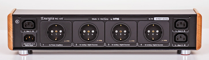

in the end .......... suceeded.
I see that you are willing to spend "some" money for a good SQ.
In Germany the company
http://www.hmselektronik.de/index.htm
has some good ideas.
The SOTA is a unit  "Energia Definitiva High End Power Supply" for appr. € 7500,00, but I can't find any reference in English, except:
http://www.hifi-phono-house.com/product_info.php?language=en&products_id=8953&XTCsid=820b71982a252ad909edba1ecae474ca
They have some smaller units (RC 4/3) with a similar concept starting with < € 2700,00 too.
