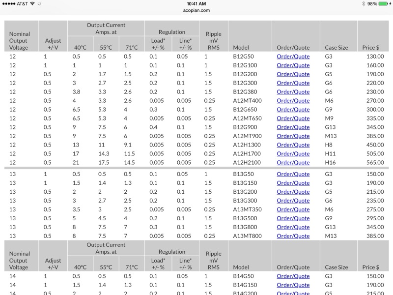

Hi Anthony,
I have 3 separate Acopian high grade power supply's with .25mv ripple and .005% line regulation, one for each MB voltage rail. (See attached spec. sheet.) I've been meaning to use your wiring & power up sequence research cheat sheet to give them a try, just haven't gotten around to it.
I'll try to get to it this weekend and report my results here. Maybe it will provide some additional useful information. I hope so anyway.
Todd

« Reply #157 on: August 18, 2015, 05:09:32 pm »
Todd, I have resized your image a bit, so it is better readable.
« Reply #158 on: August 18, 2015, 05:21:32 pm »
Todd, I only say this so that Anthony doesn't need to possibly embarrass someone :
Anthony talks about 14uV at 8 Amperes, while you talk about 250uV at 8 Amperes.
Also from your picture I can derive that at 8 Amperes it will merely be 1000uV.
then play with the "good" power supplies (say 1mV RMS noise @8A
1mV = 1000uV
Now that is out, please continue. Happy Happy

toddn
Posts: 66
« Reply #159 on: August 18, 2015, 05:36:00 pm »
Ah yes, I see now. micro volts vs. millivolts
Thank you Peter.
« Reply #160 on: August 18, 2015, 05:48:41 pm »
Seems quite unbelievable anyway, Todd.

« Reply #162 on: August 18, 2015, 11:16:03 pm »
Hi Anthony,
Todd
Hi Todd,
Those Acopian supplies look fine, so I will be quite keen to hear how you go getting your motherboard to start and of course how everything sounds.
