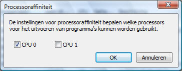

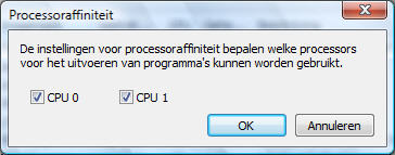

Anyway, today you can check things, by choosing Scheme-1 (not the others !), start Playback, and look for the Processor Affinity for a few random processes (Taskmanager, Processes tab, rightclick on a process, choose Set Affinity -> is only there when you have more cores !). When only one core is ticked (not by you), you have it working.
A random process gives, two cores checked see screen 1
XXHighEnd gives the message "No access" see screen 2

« Reply #5 on: November 25, 2007, 01:37:36 pm »
When i do XX it shows the cores....
« Reply #6 on: November 25, 2007, 02:05:40 pm »
A random process gives, two cores checked see screen 1 (version 09s-1)
After a reboot and playing XX version 09pd, Set Affinity gives:
  • for Process XXHighEnd, still no access;
  • for a random Process, see attachment
« Reply #7 on: November 25, 2007, 02:10:07 pm »
Does that have anything to do with administrator rights?

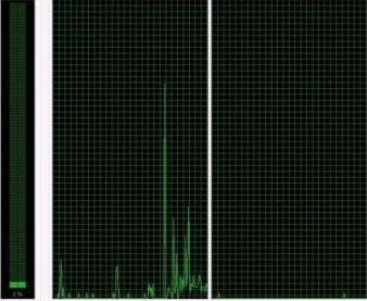

Then I downloaded S-1 a week ago (installed all the files from the new folder) and applied same settings and startet playing, with better SQ as a result. I also checked with Taskmanager and it was working similar as before (as with M-1), with a lot of activity in core one, and minimum activity in core two. See photo. It is taken when Engine 3 is playing a playlist in unattended mode, while I am keeping the PC busy with other tasks.
What do you think is the situation now? Should I download new version again, or is eveything OK?
Please advice.
EDIT: Just downloaded S-2 and all is OK!
« Reply #10 on: November 25, 2007, 08:40:37 pm »

« Reply #11 on: November 25, 2007, 09:34:38 pm »
Dear PeterSt:
I appointed core sucessfully when installing M-1.
Please advice.
Hi Pedal,
According to your "EDIT", you're okay I think. But, according to your earlier descriptions of SQ and your picture above, it seems that you were okay already.
If you are not sure, or you think SQ has degraded with 0.9-s2, set the Scheme to No Appointment and you should (no, may in your case) have the same as before (0.9s-1).
