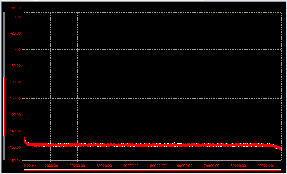

I am measuring the first production unit of the NOS1a anyway, so this is what I mean with a straight noise line.
In this (NOS1a) case also without any anomaly anywhere. Only some 50Hz mains pickup.
USB is streaming here.
An amplifier should add nothing to this (now new peaks); only gain.
This could not be done before and what it should tell us is that this now is a reference. Meaning : When any next NOS1a shows something here, it is not right. Simply : because it can be done apparently.
And FYI : Yesterday this was not the case (didn't make screenshots of it). So *now* pure theory comes about : It should be like this because of the total isolation and when all soldering is right nothing can show. Of course it takes more like the components used and PCB layout etc., but we shouldn't underestimate the reference this now brings. I know, it is a technical reference but in the end all is; My previous posts were all about references although from different angle and in different realms/domains. But once you have such a reference it will be the base for the next development. So for example, a next development may bring down the noise more. Nice. But now peaks show again. And thus the next development will be about bringing down those peaks. And so on.
Low noise so what ? well, think about how 24 bits can resolve. This can only be done when first the noise is lower than that (-144dB).
And so we continue ...
