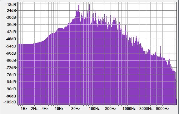

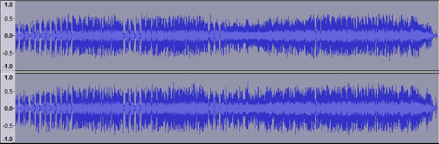

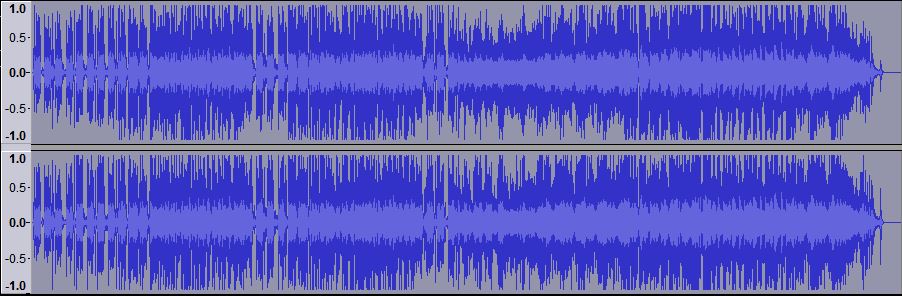

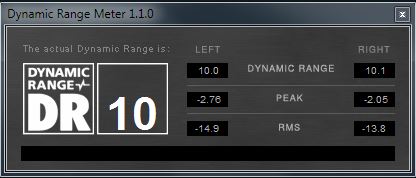

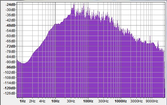

« Reply #40 on: November 21, 2014, 12:19:50 pm »
Otherwise I am not sure how you are going to play anything from an LP which has been high passed (~30Hz) for LP (haha) while an original master didn't undergo that high passing.
Hey Peter, technically the LP is better than the CD!!! Look below. The compression on the CD is terrible. I wondered how the CD could sound so much louder than my needle drop, even though I was going reasonably high in level. And now I know. I think this might be a good example of people being impressed by artificial loudness!
And also, where's the drop off below 30Hz on the LP? There isn't any!
Yayayaya, that is how you look at it. But I look at it somewhat differently; This is not much compressed at all, however it is limited somewhat (say the 2dB of difference you see on the DR).
Otherwise don't get hung up too much on "compression" or whatever, because almost all CDs have that. But this is a very different property than detail etc.
FYI: The other day I spent a full day on measuring interlinks (up to 5MHz) to see whether I could find even the slightest difference between an in my view good performing one (Blaxius) and a totally dull situation like "wrongly modded" NOS1a plus different IC etc. ... Nothing of course. Also not with these kind of spectragrams.
On the bass side of things ... a bit of the same story. But if you want : what do you mean "no roll off" ?
[I am not saying that this is with real merit, but still you can think  it over]
Elsewhere I tried to explain what the high pass implies. This is NOT a steep roll off on the left side of 30Hz. Now I am confident you see a difference, and it is only (merit !) to determine where this difference comes from and how real it is. Still I already told somewhere (measuring from the speaker) that depending on the recording the LF goes all the way to DC. Your speaker does that too but with huge roll off beyond say 16Hz (but starts at 19Hz).
I can say it a 1000 times ... feel your woofers. Don't tell me you are afraid of it ? I mean, you never ever responded to this, while here too this is totally clear (yes, I did). Try to learn how DC feels (not a frequency but larger "blobs"). Your spectragraph shows it (FWIW).
Of course it is not important to feel something because it is about hearing/perceiving something. BUT from what you feel you can learn to hear or perceive it with as the next step how to improve or how to easily see (feel) that things got worse without readily recognition. If you do this with this track, you would never dare to say that there's no difference (with the proove of a plot which we all might not read easily for all there is to interpret).
What you can also do is switch on your DC metering in your NOS1a and look at it. The DC shows there too. Takes a bit of learning plus interpretation of the 3x or so per second update but you can see it (I don't know about this track and how the both versions will compare).
Yes, I know, you have to be with a nice drink in your basement for it, but alas. Haha.
So no, your plots to me don't show much (just because it can be 100 times worse).
Btw, your left headroom for the needle drop is around 6dB. So twice as soft for that reason alone. Nothing wrong with that (my opinion) but the explanation for your "wondering".
OK, I'll try this.
But you can clearly see that the LP recording is identical in output to the CD from 10Hz upwards, i.e. there is no 30Hz high pass filter as you implied. And furthermore, the steep drop-off below 10Hz in the LP recording is a testament to how well-behaved my turntable/arm/cartridge are - little or no rumble.
If DC to 10Hz is really that important, then you have a point. Personally, I think it's the speed of the bass in the CD that makes it better, which of course is not shown by these plots.
Well, if you think 'limiting' on CDs is OK, then perhaps. But for me, it is totally, totally unnecessary - I mean, why do it?... Unless it's to have an artificial way of increasing micro details (as the RMS level is massively increased, and hence the low-level signals also).
So you agree that the CD sounds better.
Better than my recording, yes - there's more micro detail and the bass is tighter and faster.. Better than the LP, I'm not sure yet.
But what about your idea of the external device recording being detrimental then ? I mean, can you see it in the plots ?
No, of course not. Interfacing to an external device probably introduces a bunch of RF reflections and noise induced jitter, which 'deaden' the sound, but which won't show up on these plots.
Overall, the plots won't tell you how something sounds. But they're great for identifying 'cheating'. In the case of the CD, having to limit at -0.5dB full scale to make it sound 'good'. Just my opinion.
