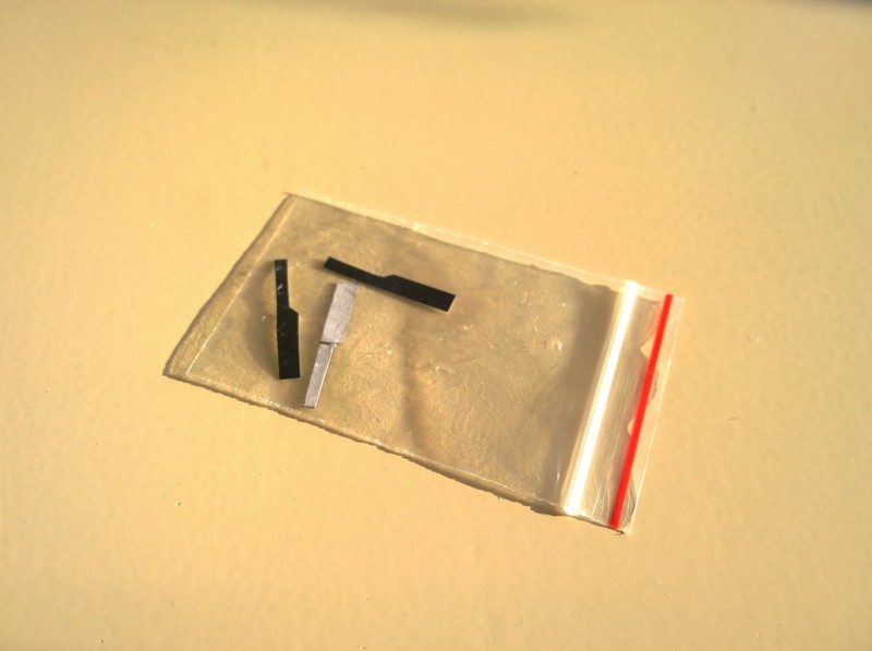

Because at first I was rather enthusiastic about the results without the power, we made a set of these for you all :
Two is enough - one is spare.

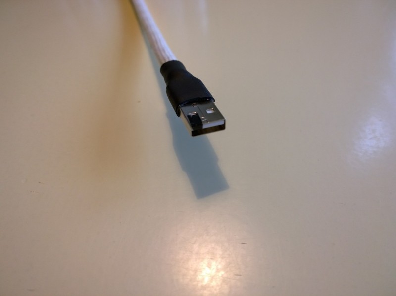

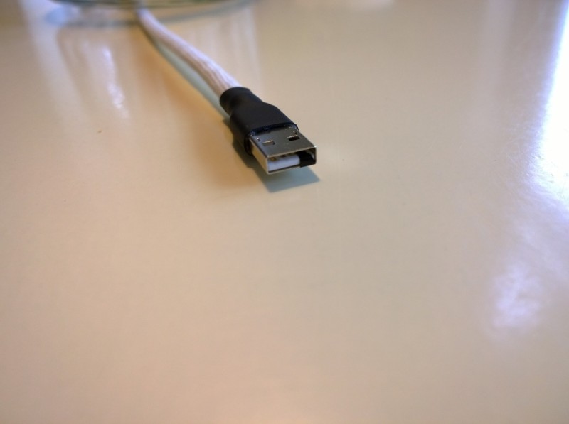

Below you can see how to apply it when you want to try without the power wire.
If you look above again, you see one of these self adhesive "pads" upside down. The protective paper is cut in the middle. Now you can peal off the bottom part (the thinner part) which goes to the inside of the connector.
Look above and below for the position of the pad for of the A connector.
Grab a tooth pick which you can put through the hole in the connector to additionally press the padd. Try to press it over its full length so it will stick everywhere.

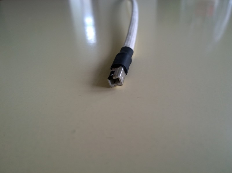

Above you see where to put the pad for the B connector.
When you are finished with positioning and pressing the pad so it sticks well, you can peal off the other protective piece of paper and fold the tape as you see in in the pictures so that remainder part now will stick to the outside.
You can now put in the cable and pull it out and the pads will stay. Number of in/out times won't be infinite of course.
Already-owners of the Clairixa (or others) can make these pads like this :
Total length is 28-29mm.
The thin part is 3mm of width.
The wide part is 5mm of width.
Notice that the wide part is only wider so you an hold it better during the assembly - otherwise it has no function. However, it will stick better to the outside now as well.
The thin part should not be mangled with for its width.
